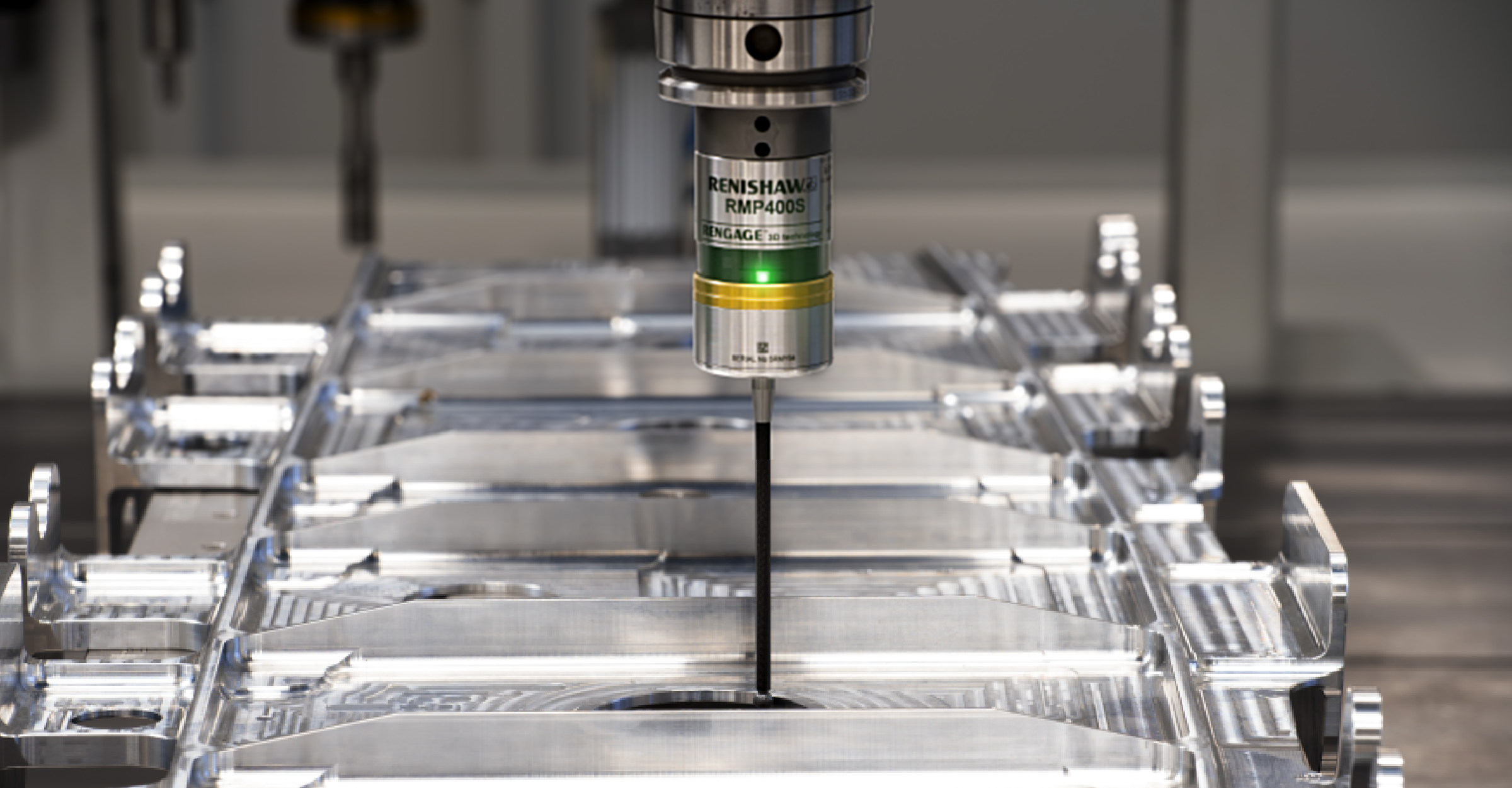

Renishaw has announced the market introduction of its multi-purpose RMP400S sensor at the upcoming IMTS 2026 (14-19 September) and AMB 2026 (15-19 September) exhibitions. The RMP400S represents an innovative solution that seamlessly combines touch-trigger, scanning, and surface finish verification into a single machine tool probe. This powerful combination makes the RMP400S Renishaw’s most versatile machine spindle probe to date, delivering exceptional metrology performance.
The RMP400S is Renishaw’s most versatile spindle probe to date, combining touch-trigger, scanning, and surface finish verification in a single device. Built on patented RENGAGE strain gauge technology, it can achieve a repeatability of 0.25 μm 2 σ and surface finish Ra of 0.5 μm.
The RMP400S enhances on-machine measurement capabilities by delivering high-density scanning data for both form and surface finish verification. Its advanced functionality supports improved in-process control directly on the machine, helping engineers streamline inspection workflows.
