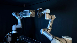

The mobile robot manipulates an Advanced Microwave Mapping Probe (AMMP), developed by the engineers at CTG under the Air Force’s Small Business Innovation Research (SBIR) program. The system uses microwave signals to non-destructively evaluate (NDE) aircraft radomes and identify defects such as delamination or water ingress. Aerobotix designed and built a system using a FANUC CRX-10iA collaborative robot, riding on a custom Automated Guided Vehicle, and using LiDAR to scan the work zone for safe navigation. The robot finds and orients to the part, adjusts the scanning paths and executes the detailed part analysis.
