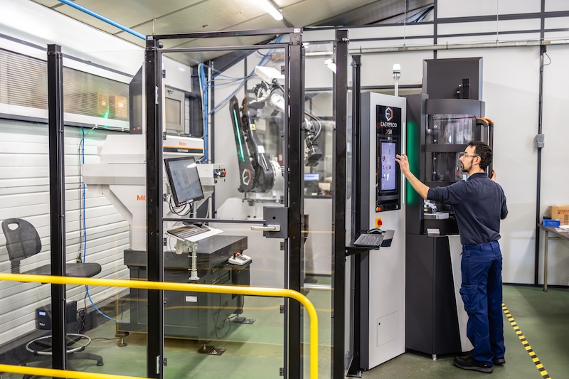

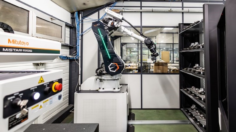

The robotic inspection cell consists of three principal elements: a Mitutoyo MiSTAR coordinate measuring machine, a multi-axis articulated robot and an automated storage system capable of accommodating up to 20 pallets carrying parts awaiting inspection.
Installed within a safety enclosure featuring transparent glass panels, the cell allows operators to monitor operations while ensuring safe separation from moving equipment. An external loading station enables parts to be introduced into the system without interrupting ongoing measurement activities.
The process begins when an operator loads a palletised component into the station and selects the relevant part type via the human-machine interface. The control software automatically associates the component with the correct inspection routine.
The robot then transfers the pallet to the automated storage system. Once inspection is initiated, the cell operates autonomously. The robot retrieves each pallet in turn and places it onto the CMM’s measuring table, where a dedicated clamping system ensures accurate positioning and stability.
The MiSTAR CMM then executes the appropriate inspection programme, measuring all required features. Depending on component complexity, this process may take anywhere from a few minutes to several hours. Once measurement is complete, the robot returns the pallet to storage before proceeding to the next part.
Measurement results are automatically recorded and made available for subsequent analysis by metrology personnel.
By separating loading activities from measurement operations and automating pallet handling, the system ensures continuous utilisation of the CMM while significantly reducing manual intervention.
