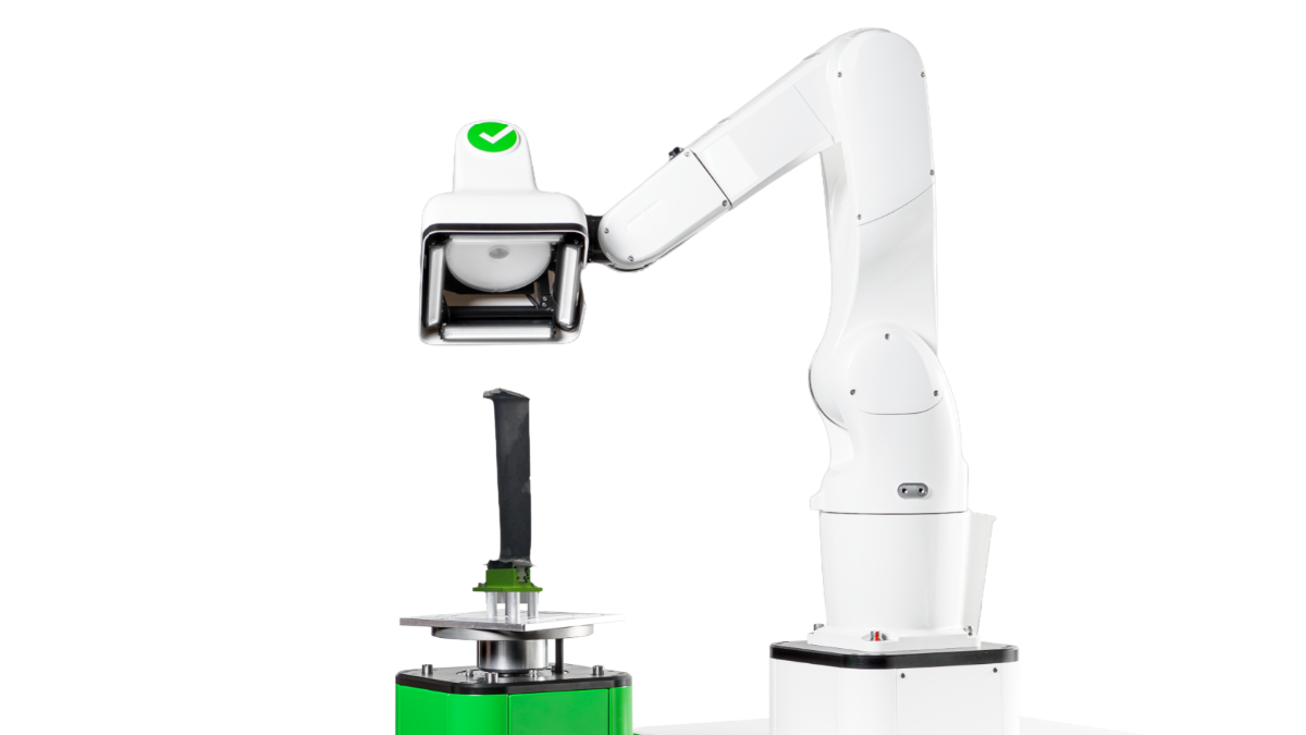

As manufacturers look to automate inspection of increasingly complex, high-value components, KITOV.ai has introduced KITOV Prime, a robotic inspection system designed to automate the visual detection and analysis of surface defects.
Launched at IMTS 2026 in Chicago, Prime combines robotic positioning, CAD-based inspection planning, multi-directional illumination and deep-learning defect detection within a single software environment. Commercial availability is planned for the first quarter of 2027.

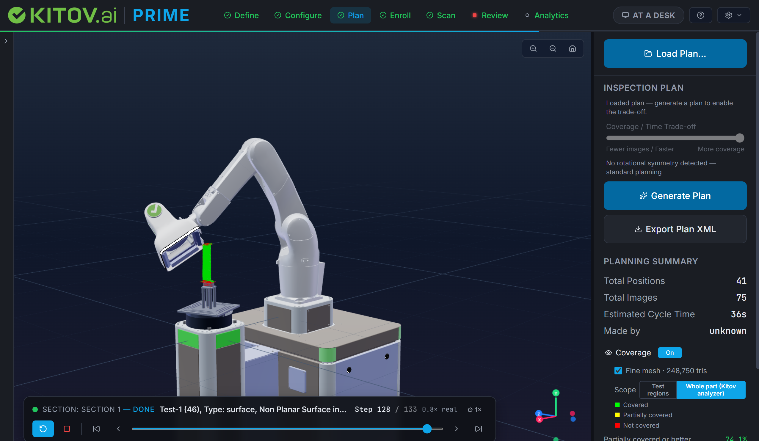

Rather than relying on manually programmed robot positions, Prime uses the part’s 3D model to generate an inspection plan. The system analyses the surface to determine camera positions from which individual areas can be viewed and illuminated while accounting for focus, field of view, orientation, line of sight and potential obstructions. For each surface element, the planner also selects optimal illumination from several directions of the optical head’s LED array.
The resulting inspection plan can contain hundreds or even thousands of images for complex components. Prime then seeks to reduce the number of positions required while maintaining surface coverage, while simultaneously planning collision-free robot movement.
For rotationally symmetric components, the system can inspect a single sector and replicate the inspection around the component. KITOV reports that, on one 52-blade disk, this approach reduced robot positions by more than 25% and cut inspection cycle time by 41% without reducing coverage.
A digital simulation allows the inspection sequence to be evaluated before production, including coverage, unreachable areas and robot motion.

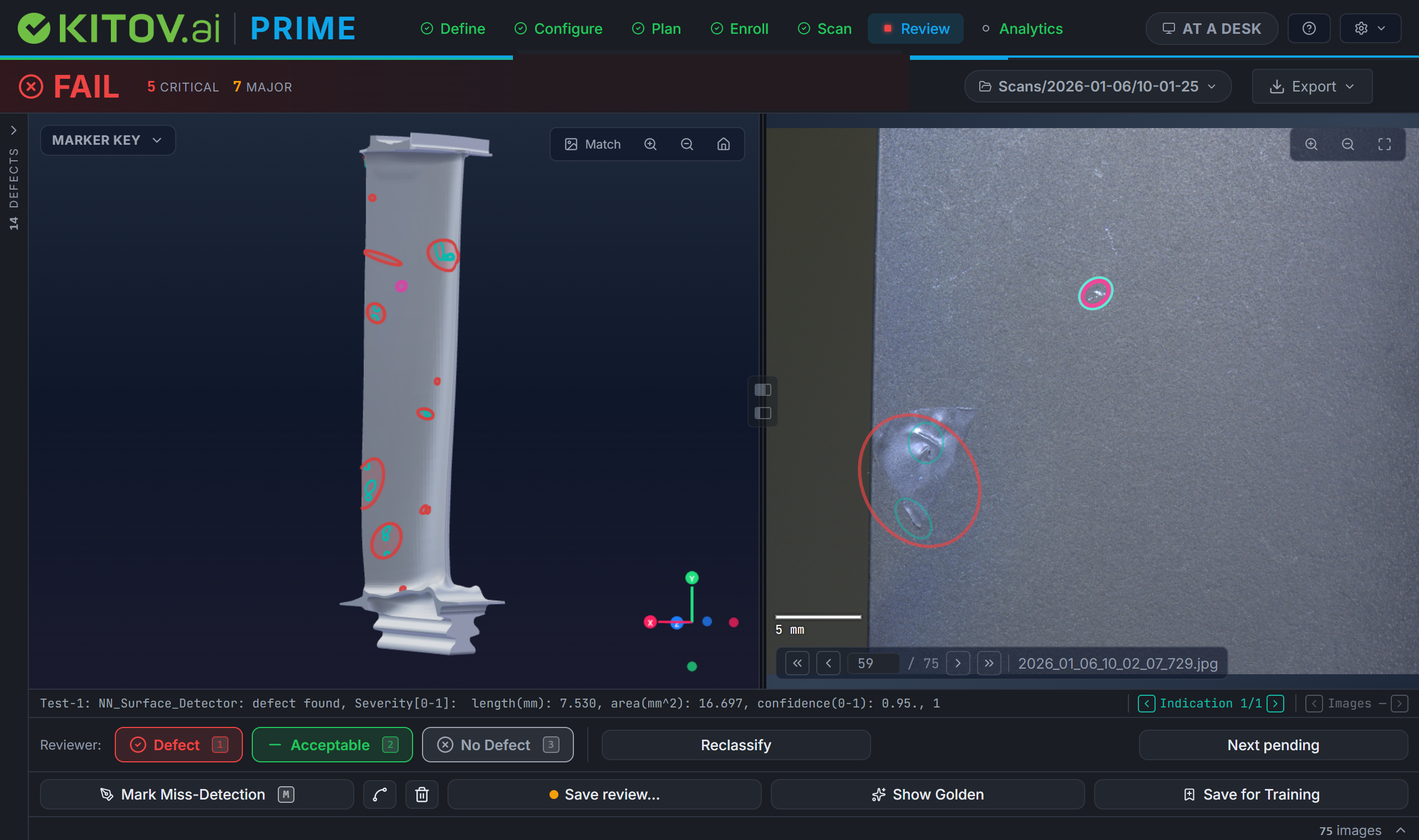

The Review stage provides a mechanism for operators to confirm, reclassify or dismiss detections and to mark defects missed by the system. Defects can be assigned to categories and severity levels, with acceptance rules applied according to defined regions of the component.

During production, AI inference operates while the robot is moving, allowing a pass/fail result to be available as the inspection cycle is completed. Defects are displayed on the 3D model as they are detected.
During review, selecting a defect on the model takes the operator to the image from which it was detected. Conversely, selecting a location in the image identifies its corresponding position on the component. Multiple observations of the same defect can also be consolidated.

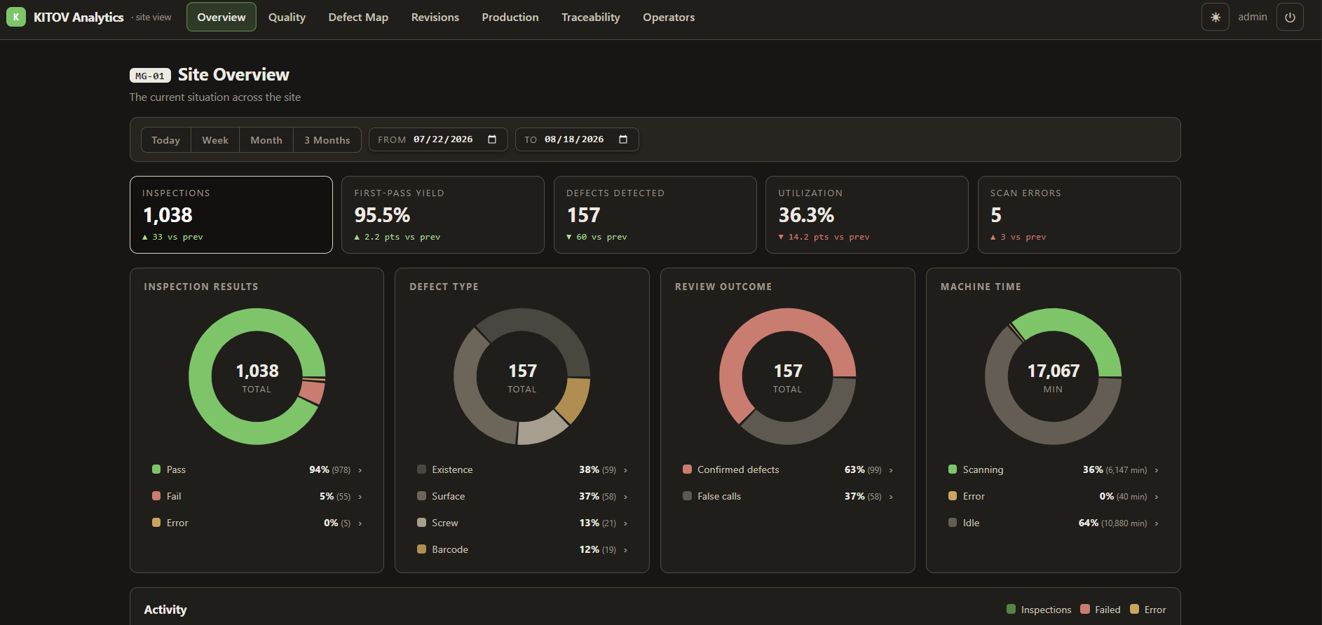

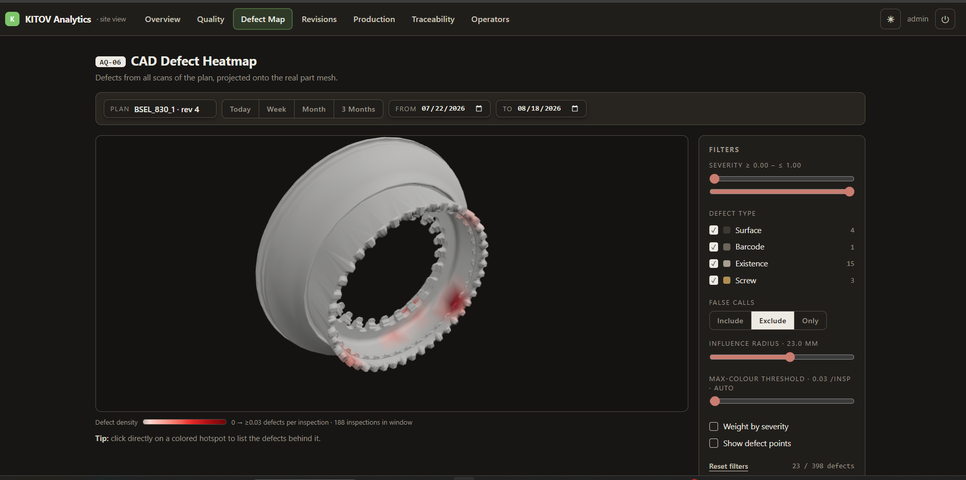

Prime’s Analytics functionality extends the system beyond individual inspection decisions. Reviewed inspection results can be used to generate production trends, defect Pareto charts, comparisons with a golden reference and spatial defect heat maps.
The spatial distribution of defects can potentially provide information about upstream manufacturing processes. For example, recurring concentrations of particular defect types may help identify issues associated with casting, machining or handling.
