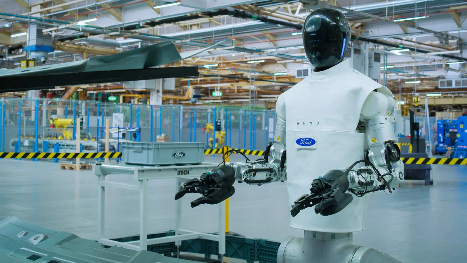

Humanoid, a UK-based robotics and AI company has completed a landmark Proof of Concept (POC) at the Ford Innovation Centre in Cologne, Germany. The Humanoid team worked to deploy Humanoid’s wheeled Alpha HMND 01 robot in two complex workflows: tote handling for kitting and dual-arm manipulation of large, metal car body parts. The joint project demonstrated how humanoid robots can take on real industrial tasks in automotive manufacturing with speed, precision, and reliability.
During the POC, HMND 01 Alpha robot autonomously moved totes between workstations with eight kg payloads. The robot sustained a full hour of uninterrupted operation, twice the target, and achieved near-perfect 97% reliability in fully autonomous pick-and-place tasks given the particular conditions of the Proof of Concept. The pick-per-hour target was exceeded by 60%, with 83 units instead of the expected 50. Humanoid leverages advanced AI technology, trained on large, diverse datasets collected across multiple platforms and environments. Thanks to this foundation, this joint POC required only one hour of on-robot data collection to deliver a high-performing autonomous model.
In the second workflow, Alpha demonstrated precise dual-arm handling of a thin, sheet-metal body component. The robot successfully navigated to a shelf, localized the part, lifted it securely, and placed it on the kitting table without issue. Despite the complexity of the workflow, the robot executed it safely and consistently, validating a task traditionally considered difficult for autonomous systems.
