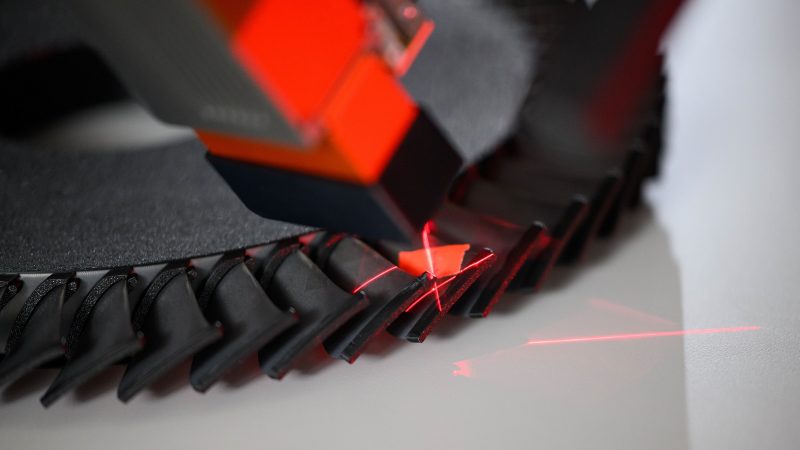

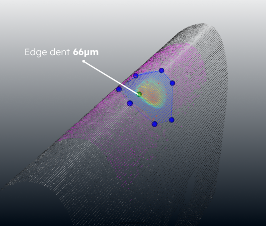

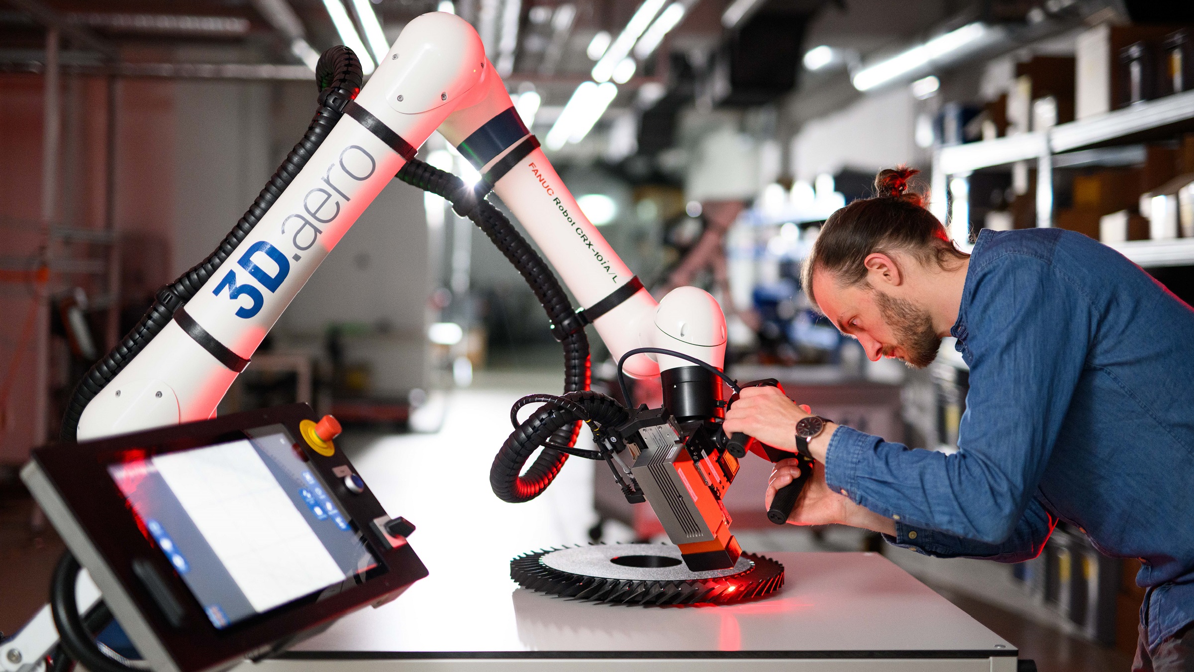

At the core of HP-FX is a White Light Interferometry sensor integrated with a collaborative robotic platform. The system enables highly accurate 3D surface measurements with micron-level lateral accuracy and sub-micron vertical resolution while maintaining the flexibility required for real-world MRO environments.
Designed for operational use on the shop floor, the mobile system captures high-resolution 3D surface data in less than a second and allows inspectors to measure defects in hard-to-reach areas of complex engine components. The technology measures a wide range of surface conditions, including highly reflective and dark materials, while generating detailed 3D point clouds that can be evaluated without extensive metrology expertise.

At MTU Aero Engines, the system supports the inspection of engine components in daily operation. Users benefit from rapid 3D measurement, standardized evaluation, and documented results. In many applications, organizations report that up to 90% of defects previously requiring replica measurements can now be assessed using HP-FX, significantly reducing laboratory workload while improving process efficiency.
The technology is no longer emerging. With twelve systems currently operating worldwide, including six across MTU sites, HP-FX has evolved into a proven solution for organizations seeking more efficient inspection processes without compromising measurement quality.

Recent software enhancements have focused on simplifying operation while increasing consistency. New capabilities include Click-to-Move positioning, automatic inspection suggestions, enhanced evaluation tools, and one-click reporting that streamlines the workflow from defect detection to documentation.
By guiding inspectors through structured workflows and smart evaluation routines, HP-FX helps deliver objective and reproducible results while minimizing operator-dependent variation. This supports reliable defect assessment across teams with different experience levels.
