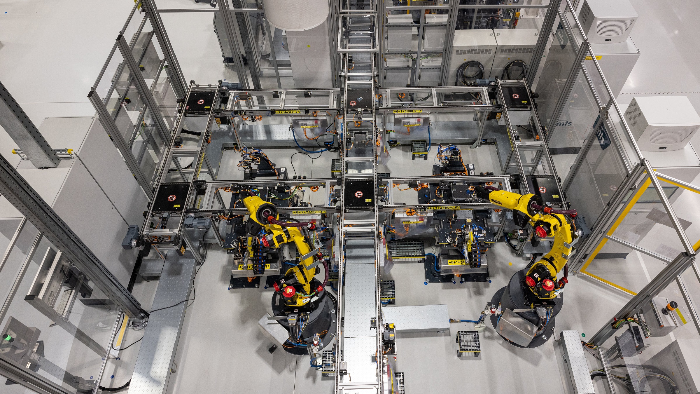

In a complex, precisely orchestrated manufacturing process, 32 individual battery cells are combined to create a completed module. Six of these modules together form the high-voltage battery used in the Cayenne Electric.
The module production process essentially comprises the following stages:
- ESD and cleanliness: throughout the entire production process, the highest standards of ESD (Electro Static Discharge) protection and cleanliness are applied. These strict standards ensure excellent process capability at each stage of production, as well as the maximum possible level of quality in the finished high-voltage battery modules.
- Cell preparation: the pouch cells are first tested and prepared for the subsequent production steps.

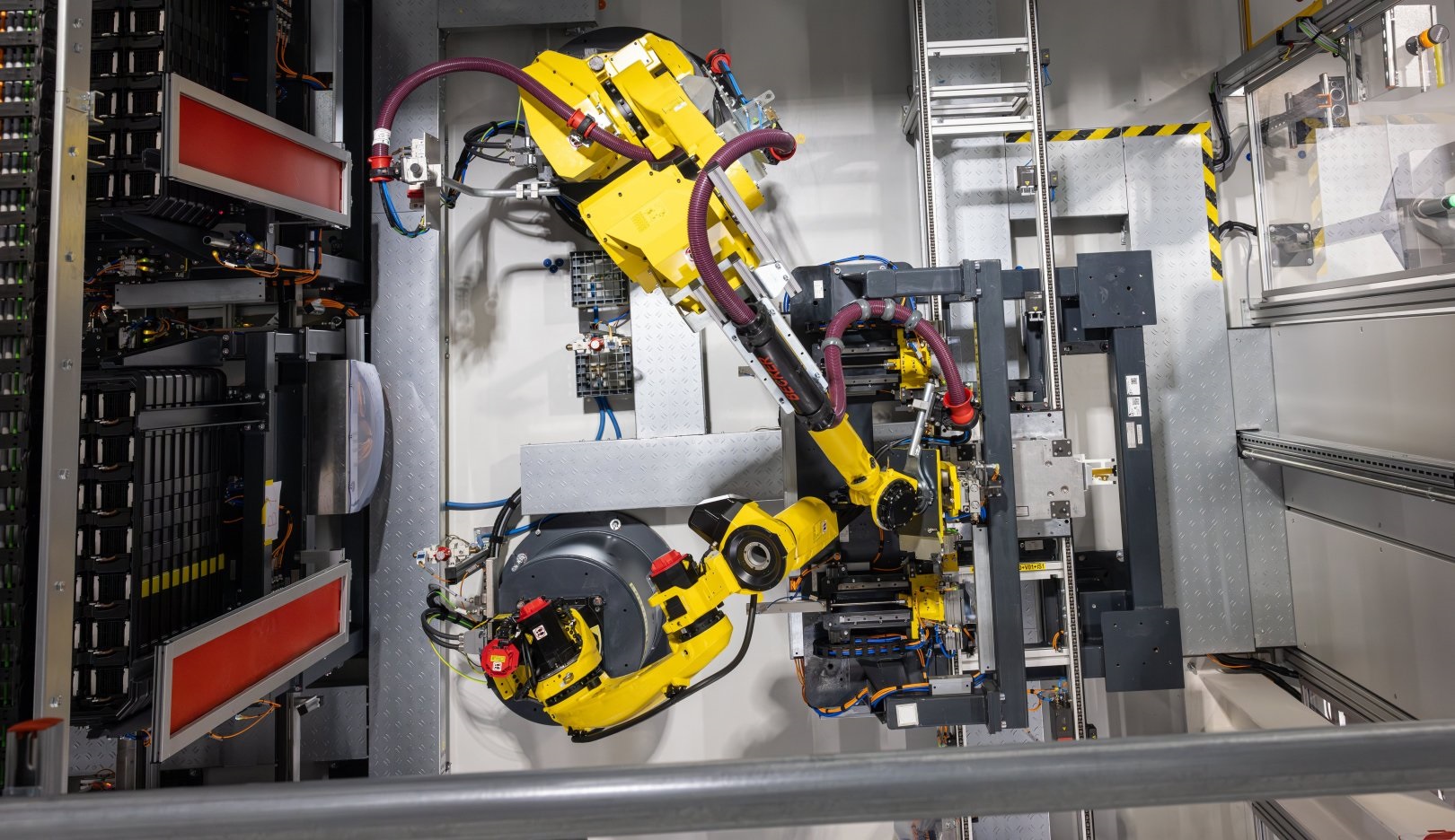

- Stack formation: the cells are stacked on top of each other, with care and attention placed on their precise positioning, finely specified spacing and uniform alignment of the electrode connectors.
- Insertion of the cell carriers and preparation of the cell tabs: the cell stacks are inserted into the respective cell carriers. The cell tabs are then positioned and prepared for the welding process.
- Laser welding of the cell tabs: the cell tabs are joined using an automated laser welding process. This process ensures both electrical contact and mechanical bonding. Continuous quality checks of the joints and stacks are carried out.
- Applying foam: a foam material is added to stabilise and protect the cell stacks.
- Module integration: four tested cell stacks are inserted into a module housing and fixed in place.
- Gap filling: a thermally conductive filling material is inserted between the cells and cells stacks, further improving heat dissipation.
- Bonding of the cooling plates: the module housing is then bonded to the cooling plates to ensure permanent and thermally efficient connection of the cell stacks.
- Top plate assembly and welding: once the cell stacks have been inserted, the top plate is put in place and welded, ensuring a fully enclosed module assembly.

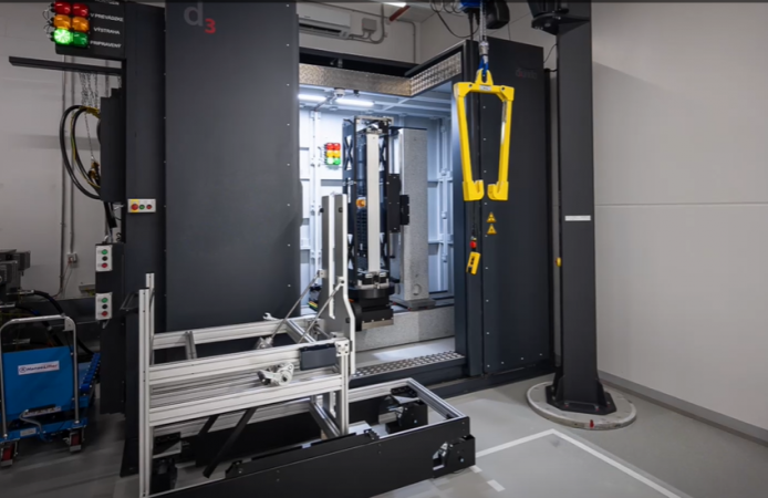

- End-of-line tests: finally, leak tests and various electrical checks are carried out, as well as dimensional checks, visual inspections, function tests and insulation measurements. This ensures that all cells are correctly welded, bonded and electrically connected.
- Shipping: once testing is complete, the modules are prepared for shipping. An external contractor then assembles the complete high-voltage battery from six individual modules.

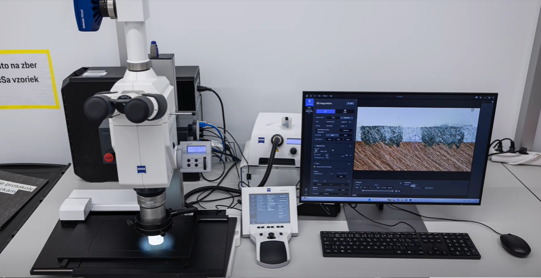

Comprehensive Quality Control
The state-of-the-art module production facility carries out real-time process data acquisition, which guarantees full transparency and control at every stage of production. Before a battery module leaves the factory, all quality criteria are checked and all production data is securely archived in the cloud. This means that each module that is signed off has been subject to continuous quality control as it made its way through the manufacturing process. This allows the plant to access and provide relevant data immediately and ensure complete traceability even after many years.
