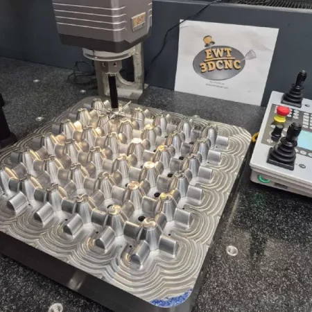

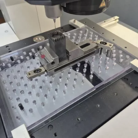

For tighter-tolerance applications and larger parts, Johannsen uses the CONTURA bridge-style CMM because it delivers the most accurate results. Touch probes also work well with reflective or low-contrast surfaces. However, touch probes also increase measuring time, especially with small or intricate parts.
Boosting Throughput with Multi-Sensor Inspection

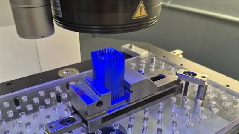

To improve throughput, Johannsen uses the O-INSPECT’s camera, which can capture many details in a few seconds. When needed, the white light sensor enables non-contact capture of workpiece topography and works well for sensitive (subject to probe deflection), reflective, or low-contrast surfaces, where other sensors make it difficult to use. Most importantly, state-of-the-art ZEISS solutions deliver repeatable, high-tolerance results.
