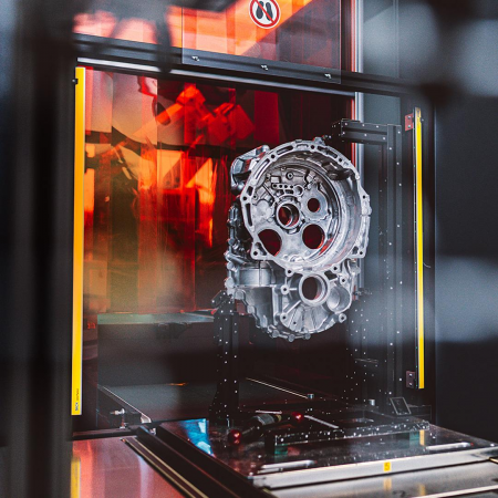

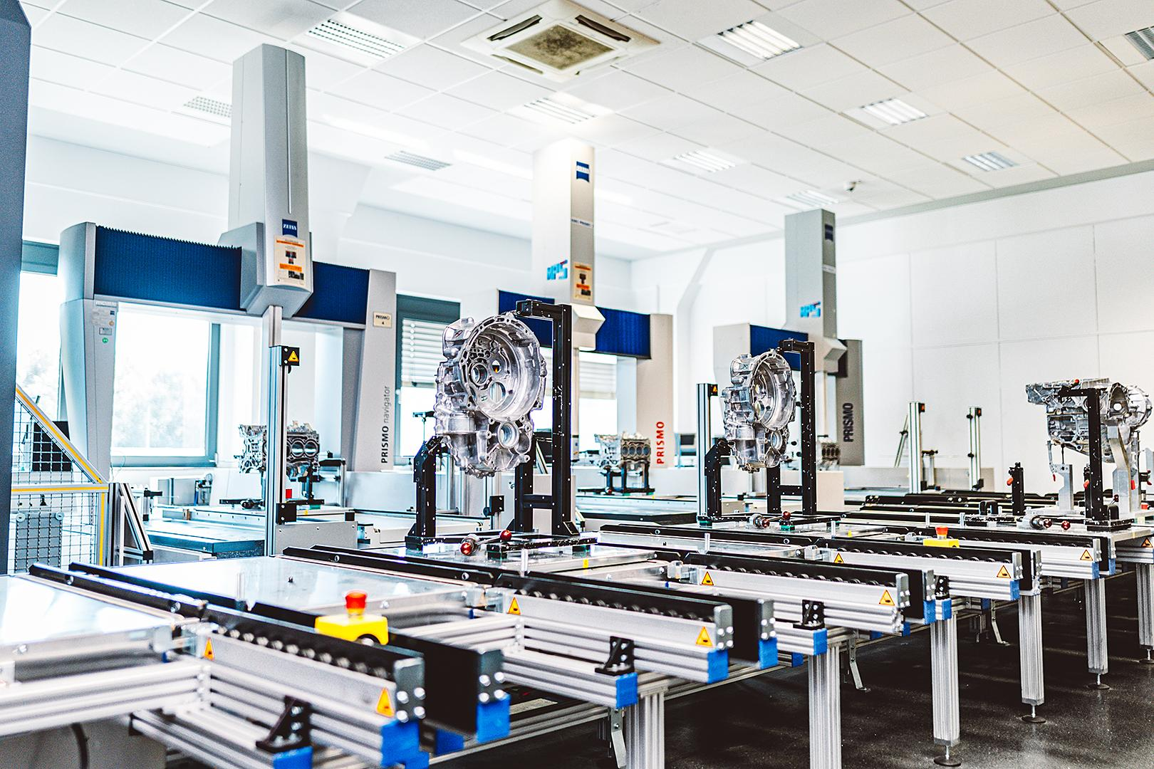

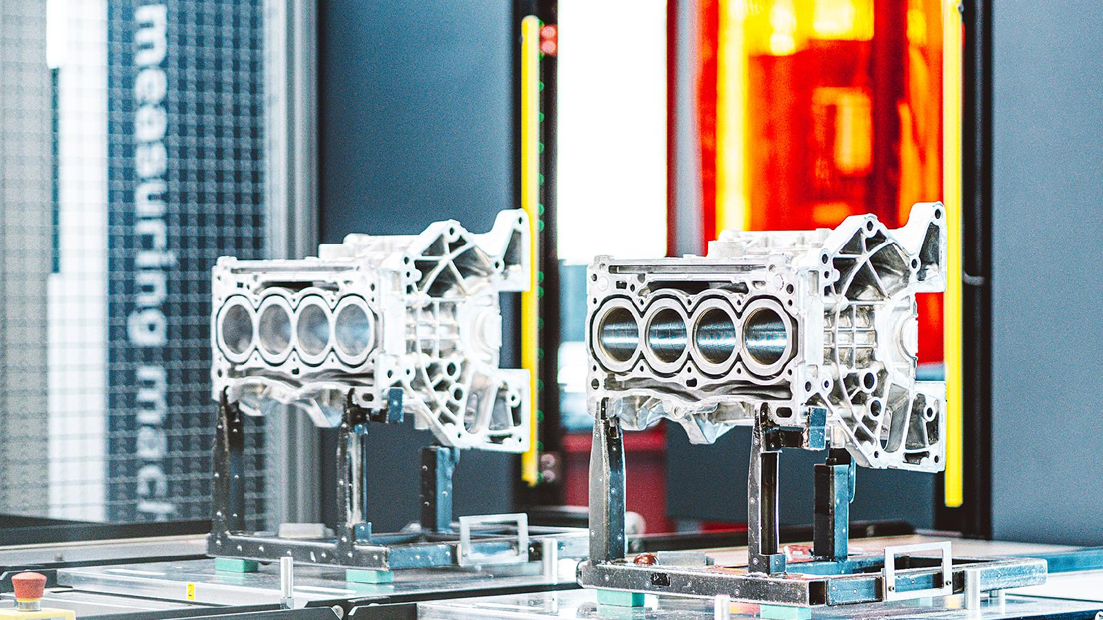

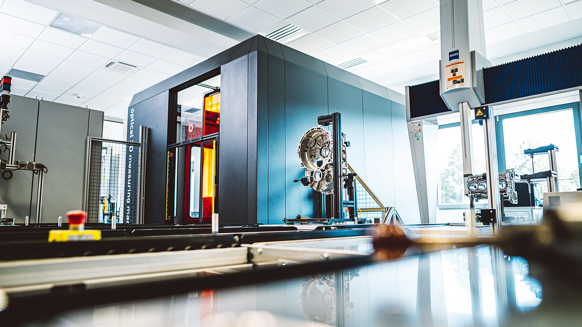

Volkswagen in Kassel has relied on ZEISS PRISMO coordinate measuring machines (CMMs) for many years. To shorten throughput times while obtaining more information during the production process, Volkswagen has also installed a ZEISS ScanBox — an automated optical 3D measuring machine that interacts with an automatic loading system from the ZEISS Integration Series comprising 14 set-up stations. The results speak for themselves: “The flexible networking of optical and tactile measurement technology has increased capacity by 30 percent”, reports Holger Giersberg.

In a large room in the foundry, the delivered cast parts are ready for inspection. First, the components undergo a visual inspection, followed by X-ray testing. Finally, quality assurance staff measure the components using a system comprising several ZEISS PRISMO CMMs and a ZEISS ScanBox optical 3D measuring machine.
“We inspect at least one component from each die casting machine per shift, which equates to 64 or more inspections in an eight-hour period”, explains Gerd Guhde, Quality Assurance Planner at the foundry. Before the new ZEISS complete solution was implemented, employees worked through their inspection plans using three ZEISS PRISMO CMMs and a manual loading system. “The process was not yet optimal because employees had to wait for their turn to measure their workpiece”, Guhde explains.

This system setup optimizes the utilization of the available measuring machines. The speed and quality of the measurement results have also improved. “Another advantage is that we can quickly record important measurement data optically in a single process and supplement missing data with tactile measurements”, explains Rene Bednar, a measurement technology inspector in the foundry’s quality assurance department. “This allows us to quickly obtain a complete measurement result for each component and recognize errors at an early stage, before they can have a negative impact on the rest of the production process.” Furthermore, thanks to the ability of combining all measurement technologies of the ZEISS IQS portfolio into one solution, all the results of the optical and tactile measurements are summarized in one report. ZEISS PiWeb reporting and statistics software with an additional integrated false color display is used for this. The system can also be used by employees without metrological knowledge.
