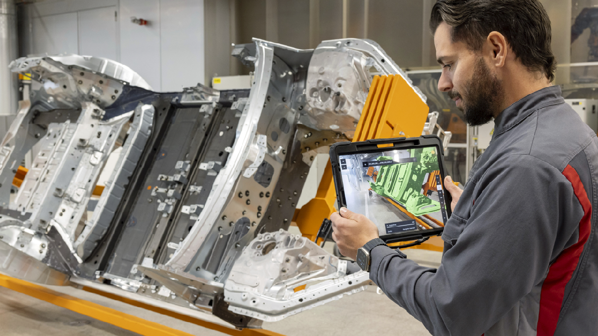

One of Audi’s key application areas for SuPAR is the inspection of workpiece carriers used for pre-assembled components. Through a tablet-based AR interface, users can visualize the required contour based on CAD SuPAR Press Release data as well as the complete 3D model directly on the real component. This allows deviations in component position or missing elements to be identified quickly and intuitively.
Detected issues can be marked directly within the SuPAR application, eliminating the need for separate manual documentation. Inspection results can then be exported as a PDF report, 3D twin, or Excel protocol and shared with the relevant departments and globally distributed partners.
Another important use case is completeness inspection in body-in-white production, particularly for joining elements such as weld studs. By preparing the project with the relevant body structure and stud data, users can perform AR-based tracking on the component, display individual studs through the structure tree, compare them with the CAD reference, and document any deviations directly in SuPAR.
