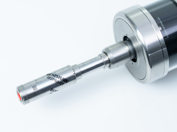

Renishaw has announced that it will unveil its new advanced ultrasonic thickness measurement probe, the RUP60, at IMTS 2026, Chicago (14-19 September) and AMB 2026, Stuttgart (15-19 September). This new probe simplifies the measurement of large parts where access is limited to a single side, removing the need to move parts to specialist measurement equipment or perform manual inspection on the machine. The RUP60 allows for an entirely automated inspection and verification process, which reduces operator involvement and provides quick, traceable results, without the need for specialised training.

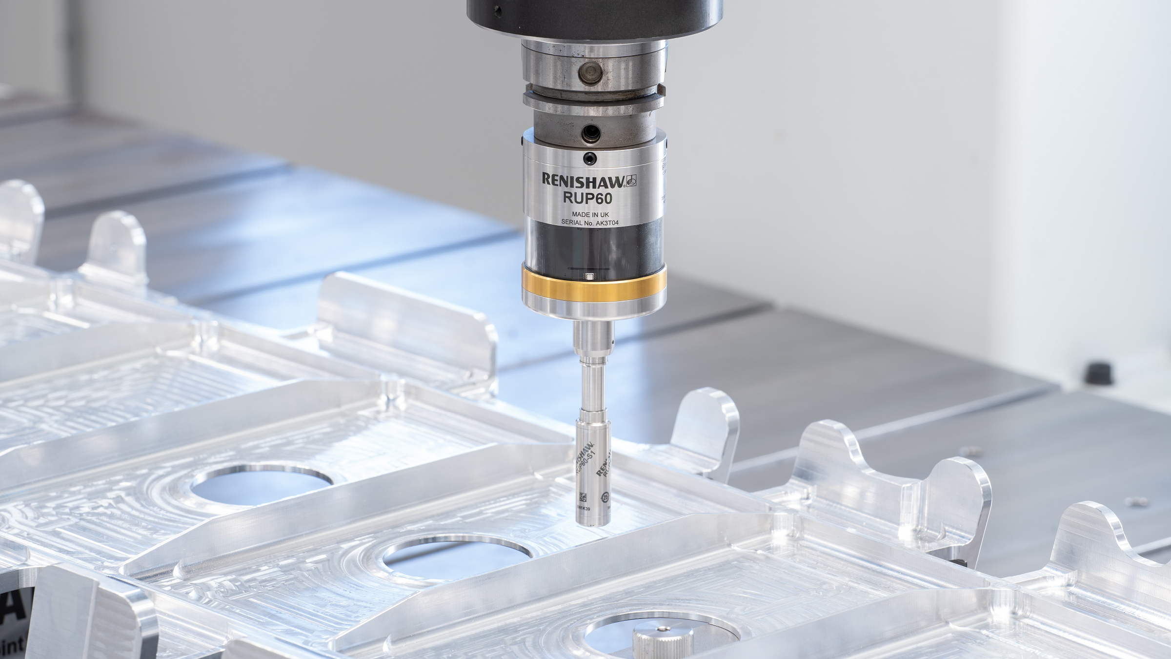

Manually measuring large metal workpieces for thickness using traditional methods is time-consuming and requires unnecessary factory floor space. They are also prone to operator errors, such as incorrect position and inadequate coupling. The RUP60 ultrasonic probe optimises this process by providing automated on-machine metal thickness measurement for materials between 0.7 mm to 30 mm, using a single stylus. In addition, the probe is robust, working reliably with and without coupling fluid, even in harsh environments.
The RUP60 eliminates user errors and ensures accurate and precise measurements for the adaptive machining of parts (cut-measure-cut). Users can achieve precise thickness measurements in just two seconds per point. This is with accuracy better than 10 µm, and repeatability of 2 µm. Without the need to remove the workpiece from the machine, the RUP60 probe reduces production steps and saves valuable factory space, time, and money.
