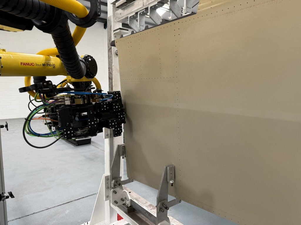

The resulting system will use a six-axis robot mounted on a mobile platform. A specialist TPR end effector will enable the system to clamp onto the aircraft structure, determine the correct position and orientation, drill and countersink the hole, measure the result and inspect for defects as part of a continuous automated process. Vision systems will assist with positioning, while integrated dust extraction will support the working environment.
