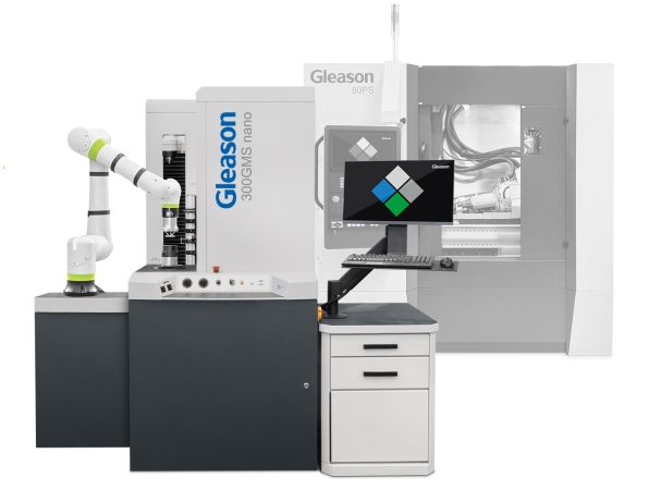

A key metrology highlight will be the 300GMSP nano Gear Metrology System, designed for production environments requiring high-resolution measurement alongside automated operation.
The system uses skidless probe technology to measure submicron surface finishes, while Advanced Waviness Analysis and KTEPS software evaluate profile and lead waviness and support analysis of gear noise behaviour.
Integrated cobot loading and connection to the Gleason Closed Loop System enable measurement results to become part of an automated production feedback loop.

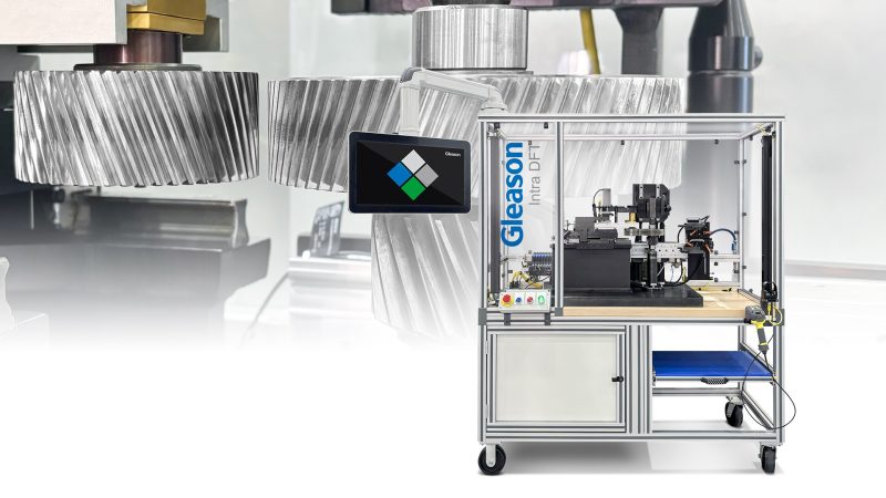

Gleason will also demonstrate Intra DFT Double Flank Testing Systems, providing rapid production verification of composite gear deviations. Intra Single Flank Testing systems are available for applications requiring detailed transmission-error analysis.
Complementing these systems, CRITERION Analysis Software provides part verification, statistical process monitoring, quality management and measurement-data traceability.
