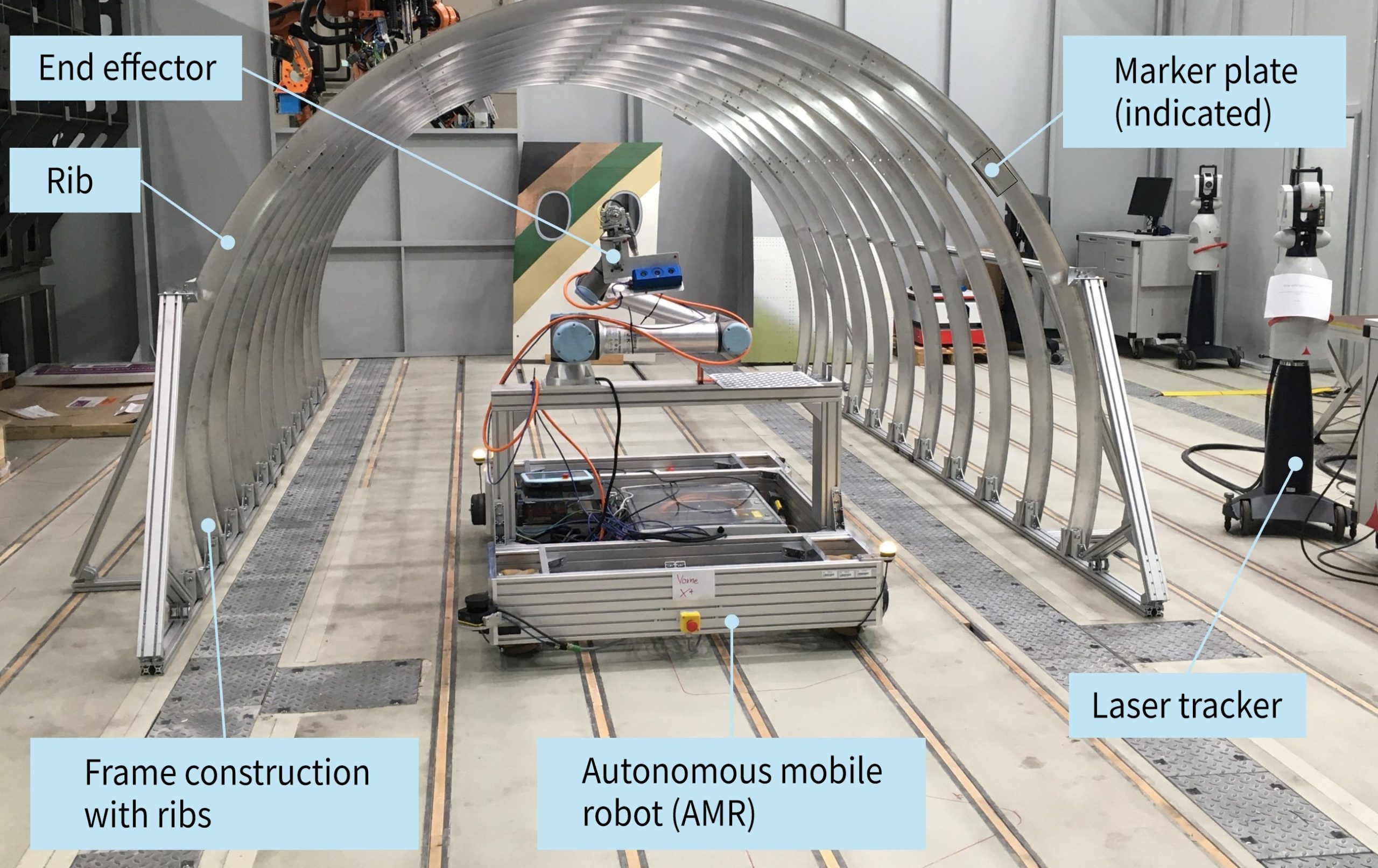

To make this digital process tangible, an automated system for marking drilling positions was developed on a mock-up of an aircraft frame structure. Several networked systems work together in this setup: An autonomous mobile robot (AMR) approaches the frame and positions itself near the target area. Mounted on the AMR is a lightweight robot that moves the marking unit, including the 3D camera, into the acquisition position. At this point, the Ensenso camera takes over the fine alignment. An integrated Manufacturing Execution System (MES) controls all sub-processes.

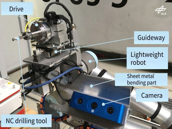

Lightweight robot with marking unit and 3D camera
The camera used, an Ensenso N36, captures the environment as a three-dimensional point cloud and matches it against the CAD data of the aircraft frame. In this way, even the smallest deviations between the target model and the actual geometry can be detected. The system uses this data to calculate precise correction values, which are transmitted to the higher-level MES. Communication takes place via a standardised OPC UA interface, ensuring reliable and secure data exchange between the camera, the robot and the control system. The MES translates the acquired data into concrete control commands for the robot, which then performs the marking of the drilling position.
The autonomous robot achieves a positioning accuracy of around 5 mm. This allows the camera to reach the acquisition position without risk of collision.

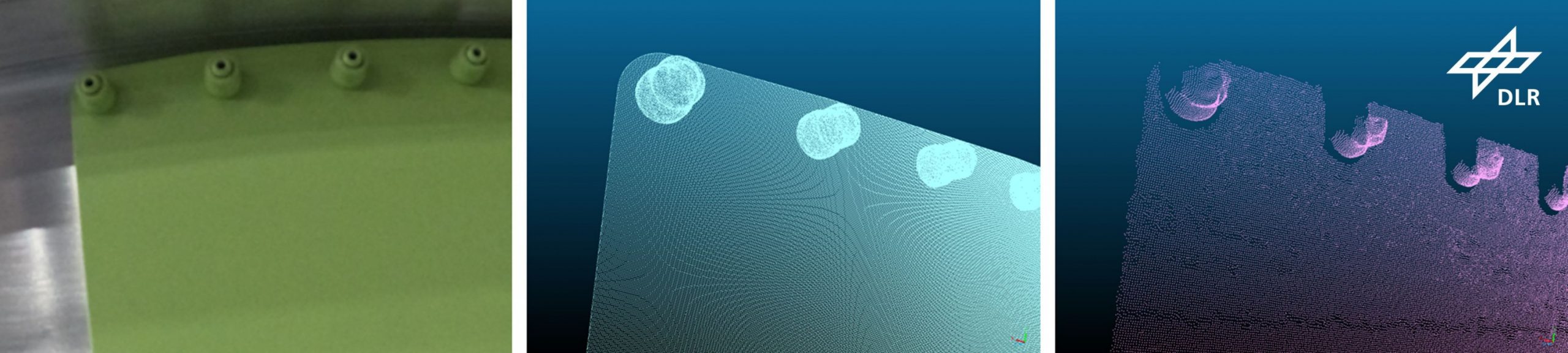

The Ensenso camera becomes a key link between digital design and real-world manufacturing: It recognises local geometries, in this case several rivets and the surface on which they are set and compares the captured point clouds with the reference data from the CAD. This comparison is made possible, among other things, by hand–eye calibration and an iterative minimisation process. The result is a transformation matrix that precisely describes the correction required for the drilling position. By applying this correction value, the drilling position can be set precisely.
Different views of a plate with rivets: actual plate (left), CAD point cloud (centre), 3D camera point cloud (right)
An operator follows the vehicle and drills the hole immediately afterwards at the marked spot. This process is repeated for each installation point, while robots and humans can work safely in close proximity to one another.
For this application in aircraft manufacturing, a compact camera with a very short working distance is required in order to keep the path from the acquisition position to the drilling position as short as possible. This helps to maintain high accuracy and avoids excessive robot movements. The Ensenso N36 meets these requirements. The Ensenso N series has been specially developed for use in demanding environmental conditions. Thanks to its compact design, the camera can be installed in a space-saving manner, either in a fixed position or mounted on a robot arm. This makes it equally suitable for 3D capture of both moving and stationary objects. The integrated projector ensures high-contrast texture even under challenging lighting conditions: It projects additional structures onto the object surface using a pattern mask with a random dot pattern, thereby supplementing missing or weak features. All cameras are pre-calibrated at the factory and can therefore be put into operation quickly and easily.
