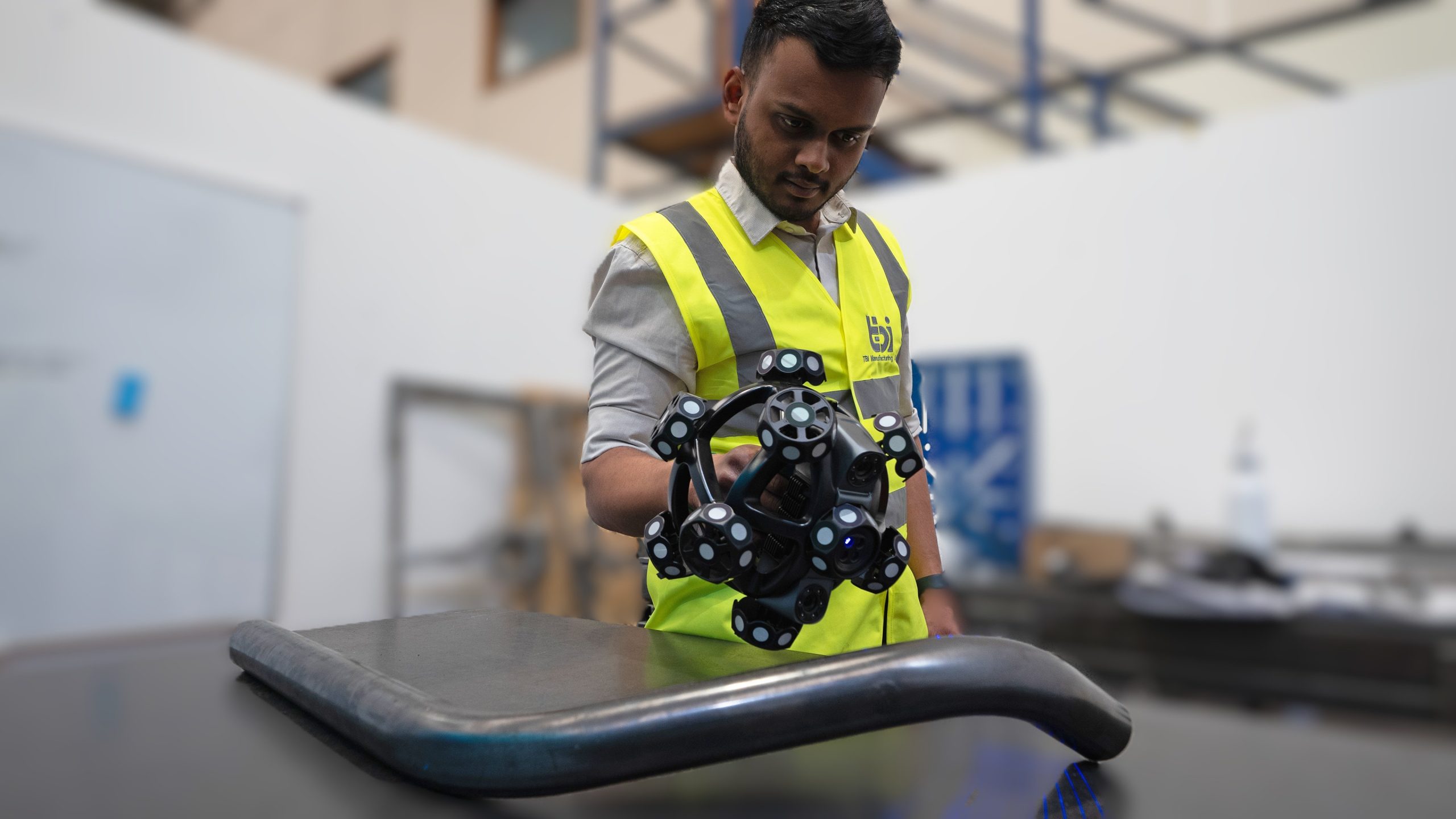

TBI considered several measurement systems, including a new conventional measuring arm, before selecting the combination recommended by T3DMC. Together, the teams evaluated how scanning and probing could complement TBI’s existing arm and provide broader validation of tooling and complete parts. Portability allowed measurement to move to larger fabrications on the shop floor, while optical tracking avoided covering the part with reference markers or magnetic targets for routine scanning.

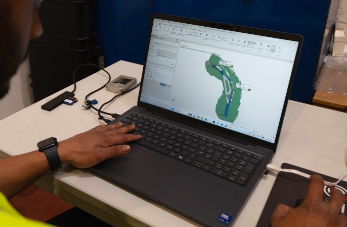

Engineers capture parts using NimbleTrack and DefinSight, then transfer the scan data through TBI’s server for comparison with customer CAD in PolyWorks. Colour mapping reveals deviations and welding distortion across complete assemblies, helping the team identify corrections and decide whether samples are ready for the customer.
Reporting can now be prepared from drawings and CAD models before the first physical part is available, then populated once scanning is complete. Results from multiple samples can also be compared within a single PolyWorks project.
“The NimbleTrack and PolyWorks have massively improved our process. With the old measuring arm, every part meant its own setup and its own report – inspecting ten parts meant creating ten separate reports. Now we can handle all of that in a single program and report, which has cut our reporting time by up to ten times” states Koushik Sujatha, New Product Introduction Engineer at TBI Manufacturing.
An early application involved four variants of a tubular light-arm assembly for two divisions of a major off-highway customer. TBI scanned successive tube bends, validated a bend-checking jig and compared completed welded assemblies with the customer’s CAD model and drawing. Scan evidence guided further adjustments as development progressed. The existing measuring arm continued to position elements within the welding fixture, complementing the broader validation provided by scanning.
