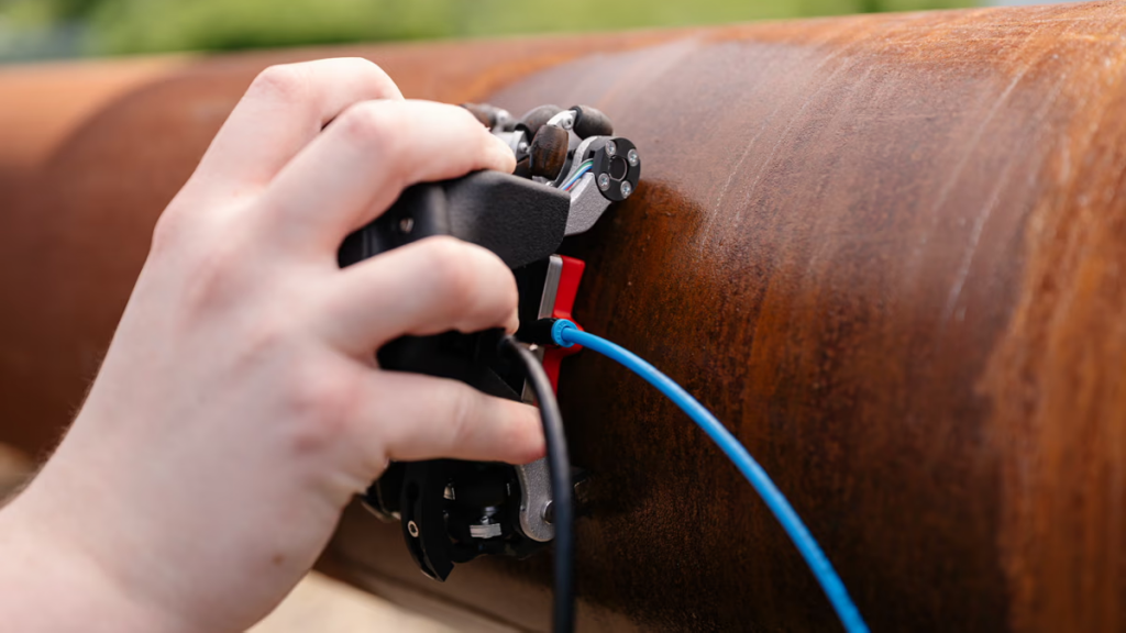

At the heart of the scanner sits Waygate Technologies’ comPAct technology, which integrates PA electronics into a thumb-sized chip. This miniaturization reduces the volume and weight of the PA electronics by 100 times and decreases power consumption by 20 times compared to common PA instruments. The result is a high-performance device weighing less than 2 kg, with compact dimensions of around 151 mm (5.94 inches) length × 95 mm (3.7 inches) width × 109 mm (4,3 inches) height and a probe width of 48 mm (1.89 inches), which can be powered via a standard USB connection. Built for demanding field conditions, the scanner meets IP65 standards and operates across a temperature range of -20 °C to +50 °C (-4 °F to 122 °F).

Krautkrämer PAXYS is designed to simplify deployment and reduce operational complexity in even the most challenging environments. Its four-wheel design with magnetic wear shoes ensures excellent load distribution and superior surface coupling, allowing it to hold its position on a structure so the operator can move freely without interrupting the scan.
The entire system, including the scanner and a lightweight Windows tablet, fits neatly in a single backpack, making it ideal for rope access work, confined spaces, or pipe inspections in trenches. With Krautkrämer PAXYS, a single inspector can efficiently manage the entire inspection workflow, a task that previously required at least two people.
For corrosion mapping, the X/Y dual-axis encoding ensures accurate defect location by tracking movement along both axes. Replaceable wear shoes with integrated couplant channels are designed to work on both flat and curved surfaces.
