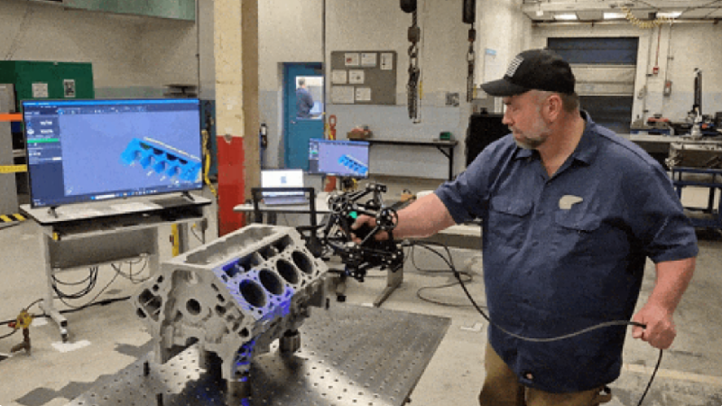

At GM’s Defiance, Ohio plant, a high-tech tool helps ensure engine components meet high standards for quality and precision. The Creaform 3D MetraSCAN doesn’t just measure parts faster; it sees them differently. As manufacturing grows more complex, teams are finding new ways to boost efficiency, precision, and product quality with tools like 3D MetraSCAN.
A few years ago, GM’s Defiance plant – one of its key metal foundries, where engine blocks and cylinder head castings are produced – started using the 3D MetraSCAN tool. It allowed workers to quickly pinpoint manufacturing conditions that fall outside required specifications.
Previously, touchpoint coordinate measuring machines (CMMs) captured parts data only at specific points. But the 3D MetraSCAN captures the entire part surface at 1.8 million data points per second, revealing fine grooves, internal channels, and surface conditions that legacy methods simply couldn’t see.
The 3D MetraSCAN offers a window into how GM’s manufacturing teams are evolving, embracing advanced technology not just to work faster, but to work smarter, and to strengthen quality processes. This scanning technology helps teams identify issues faster, fixing potential problems before parts leave the shop.

  • For castings, 3D MetraSCAN has helped drop scan times from 60 minutes per part to just ten. Setup and programming, which once took up to four hours, now takes five minutes. Tooling scans that previously required several hours are now completed in 15 minutes.
“Using the 3D MetraSCAN has been a game changer,” said Tim Scherer, pattern maker at GM Defiance Operations, who has helped lead the way. “This process obtains full-surface, high-precision analysis and insight quickly – so you pinpoint issues sooner, cut rework, and provide real-time feedback to plant teams or customer plants, minimizing impact to production.”
