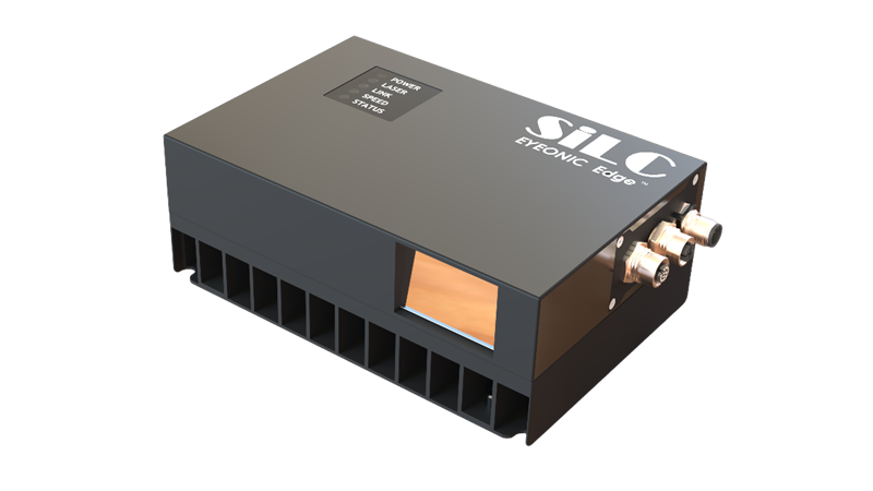

SiLC Technologies has announced the launch of Eyeonic Edge, the newest addition to their laser scanner product lines. Edge is a 4D area scanner that extends the capabilities of the company’s award-winning Eyeonic Trace, the industry’s first laser line scanner to achieve 100-micron range precision at a distance of 5 meters away. While Trace is designed for objects moving on a conveyor belt, Edge delivers sub-millimeter range resolution at distances of up to 10 meters away and is targeted to large stationary items. The new Edge product family includes two variants: Eyeonic Edge and Eyeonic Edge Ultra.
Designed for industrial and warehouse automation, manufacturing inspection, robotics and construction environments, Eyeonic Edge is eye-safe and features a large 40×40 degree Field of View with real-time region of interest (ROI) and zooming capabilities. Edge features a long operating range, from .25 meters to 10 meters, and features unprecedented velocity measurement of a target in motion. Edge is differentiated by its measurement precision, especially at long distances and operates flawlessly on objects that are traditionally challenging for imaging solutions, such as very dark or shiny objects, and performs reliably in all conditions including dim, dusty warehouses, or outdoors in bright sunlight.

- High precision: <1mm even on low-reflectivity targets and surfaces that are traditionally challenging for optical sensors, at distances up to 10 meters
- Long operating range: Edge up to 10 meters; Edge Ultra up to 5 meters
- Range precision: Edge 200 μm; Edge Ultra 100 μm
- Software-defined field of view: Up to 40°x40°
- Fast measurement rate: 1M points/sec
- Eye safe: Class 1 laser product
- Works in all lighting conditions: Day or night, inside or outside
- Immune to Interference: Unaffected by other sensors, strobes or sources of light
- 4D Data: in addition to 3D, instantaneous velocity is measured for each point
- Polarimeter: for material and surface characterization
