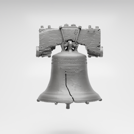

The project illustrates how measurement technologies are expanding beyond manufacturing and industrial inspection into the preservation of cultural heritage. Using an integrated suite of high-precision laser scanning, structured-light scanning, LiDAR, photogrammetry and immersive imaging technologies, the team has created an exceptionally detailed digital archive of the Bell’s geometry, inscriptions, surface texture and its famous crack. The resulting digital twin is intended to provide a permanent record of the artifact while making it accessible to researchers, educators and the public worldwide.

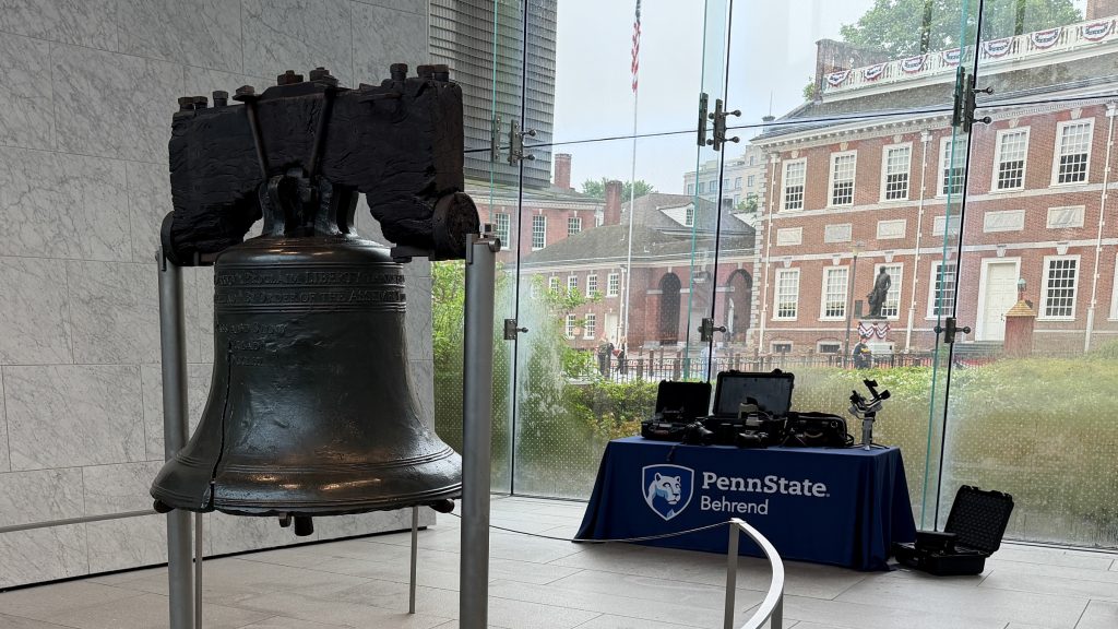

The Liberty Bell remains on public display inside the Liberty Bell Center at Independence National Historical Park in Philadelphia. Rather than working in a controlled laboratory environment, the team operated within an active museum, where every stage of the measurement process had to be carefully coordinated around public opening hours.
Access was limited to three tightly scheduled capture windows before and after the museum opened, providing just eleven hours across two days to complete the entire field deployment. Within those narrow windows, the team had to acquire, review and validate the measurement data before leaving the site.

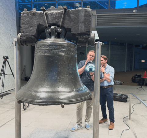

The project also maintained strict conservation standards. Throughout the deployment, the Liberty Bell was never touched, moved or altered. All measurements were obtained using completely non-contact methods.
Combining Complementary Measurement Technologies
No single measurement system could capture every aspect of the Liberty Bell with the required level of accuracy and completeness. Instead, the project combined multiple complementary technologies, each contributing different strengths to the overall digital preservation workflow.

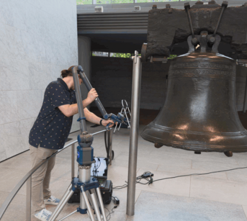

At the heart of the project was the FARO Quantum X FaroArm equipped with xS and xR laser-line probes. Delivering measurement accuracy in the range of 10โ€“25 microns. The articulated arm captured the Bell’s fine geometry, surface detail and crack morphology with exceptional precision.

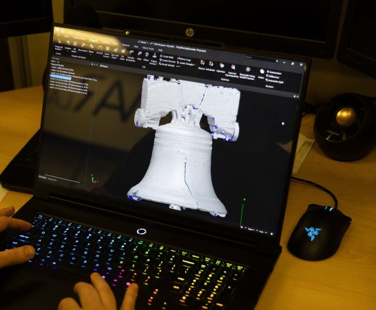

On-site processing and validation were performed using PolyWorks, Artec Studio and Lenovo high-performance mobile workstations. This enabled engineers to review measurement quality immediately, ensuring adequate coverage before equipment was packed and the limited access period ended.

The Liberty Bell presents a particularly compelling case. The famous crack that defines the Bell, its inscriptions and its weathered bronze surface all represent a specific moment in the artifact’s history. By capturing these features at research-grade resolution, the project creates an enduring record of the Bell’s present condition.
Unlike photographs alone, a digital twin allows researchers to examine geometry, dimensions and surface characteristics from virtually any perspective while preserving measurement data that can be revisited long after the fieldwork has been completed.
