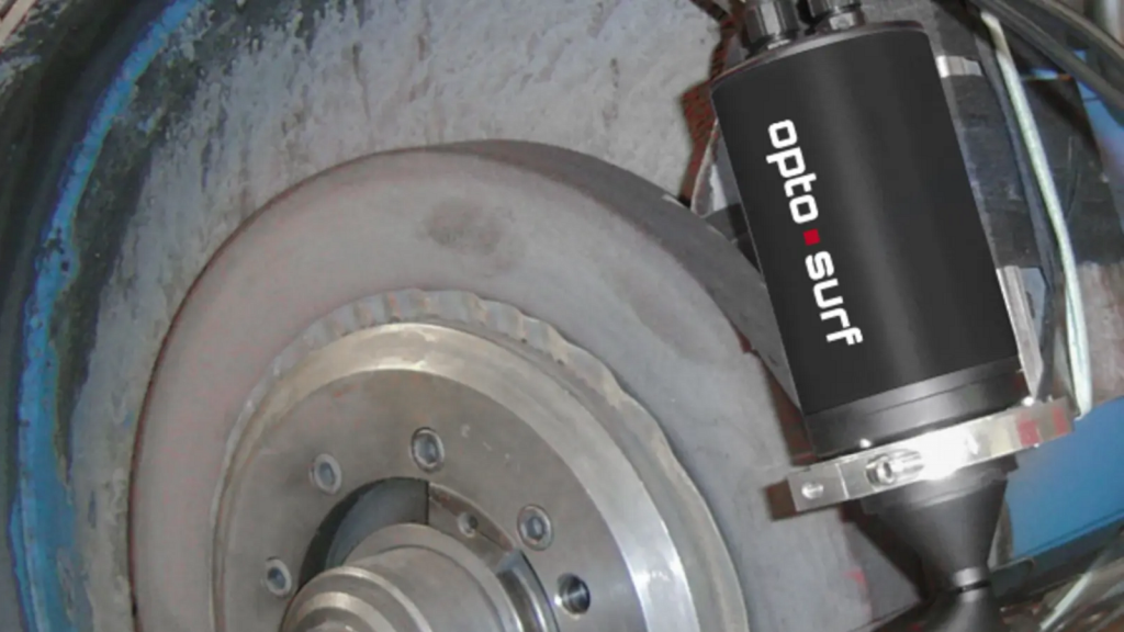

With the OS 800 scattered light sensor from OptoSurf, the quality of the rollers can be monitored directly in production. In this way, the individual processing steps can be quantitatively determined and an even service life of the rollers in the scaffolding can be guaranteed. “This makes it much easier for operators to plan the use of tools. This reduces costs through increased process stability and improves the utilization of the systems. Production losses due to worn rollers can be largely avoided,” says Kopp.
The OptoSurf Sensor OS 800 works with a measuring speed of up to 8,000 individual measurements per second and determines parameters that correlate directly with the pressure distribution in the gap, such as the variance of the angular distribution Aq, a measure of the area of the roughness. In addition, shape deviations can be determined via roundness (LSC RONt) and waviness via FFT analysis. The device uses LED 670 nm with 0.9 mm measuring spot as the light source, and a switchable second measuring spot with 7 mm is also available as an option.

The simplest method of using the stray light sensor for full-surface surfaces of rollers is to integrate the sensor into the processing machine, for example on the CNC control along the roller. A separately mounted proximity switch triggers the sensor before each revolution, so that the linear motion is synchronized with the revolution. This ensures a measuring point density on the roller at the same distance.

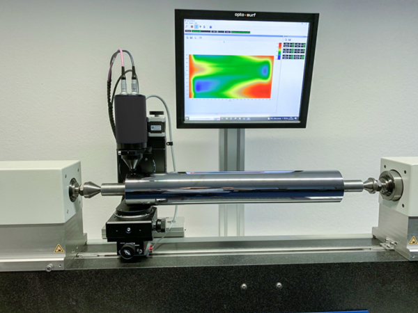

Measuring Machine OptoRoll
If one hundred percent measurement of the rolls is necessary before installation in a rolling stand, the rolls can be measured with the separate OptoRoll measuring machine due to time constraints. This makes it possible to scan rollers up to 160 mm in diameter and 1,100 mm in length. Different types of rollers can be stored in a database together with the measurement parameters. The worker calls up the roller type and the measurement runs automatically. A circumference measurement takes about one second, which means maximum process reliability with minimum time expenditure.
The measuring distance of the scattered light sensor is automatically set to 5 mm via a distance sensor, and an encoder signal controls the measuring points on the circumference. “Compared to measuring in the grinding machine, this has the advantage that the measuring distances are always the same, even if the rotation speed is not uniform. As an option, a Zumbach diameter sensor can be installed in order to simultaneously measure the crowning of the roller along the sheath line in the μm range,” says the measurement expert.
The result with scattered light technology is convincing: Ambient vibrations, temperature fluctuations and short cycle times often complicate inline measurements for quality control and only allow the use of stylus devices or measuring microscopes outside the production process to a limited extent. “Compared to many other measurement methods, scattered light sensors, on the other hand, are particularly robust against the influences of an industrial production environment,” Kopp summarizes. “Vibrations, temperature fluctuations and high process speeds have much less of an impact on the measurement results. This provides our customers with fast and reliable information about the quality of their surfaces, even under demanding production conditions.”
