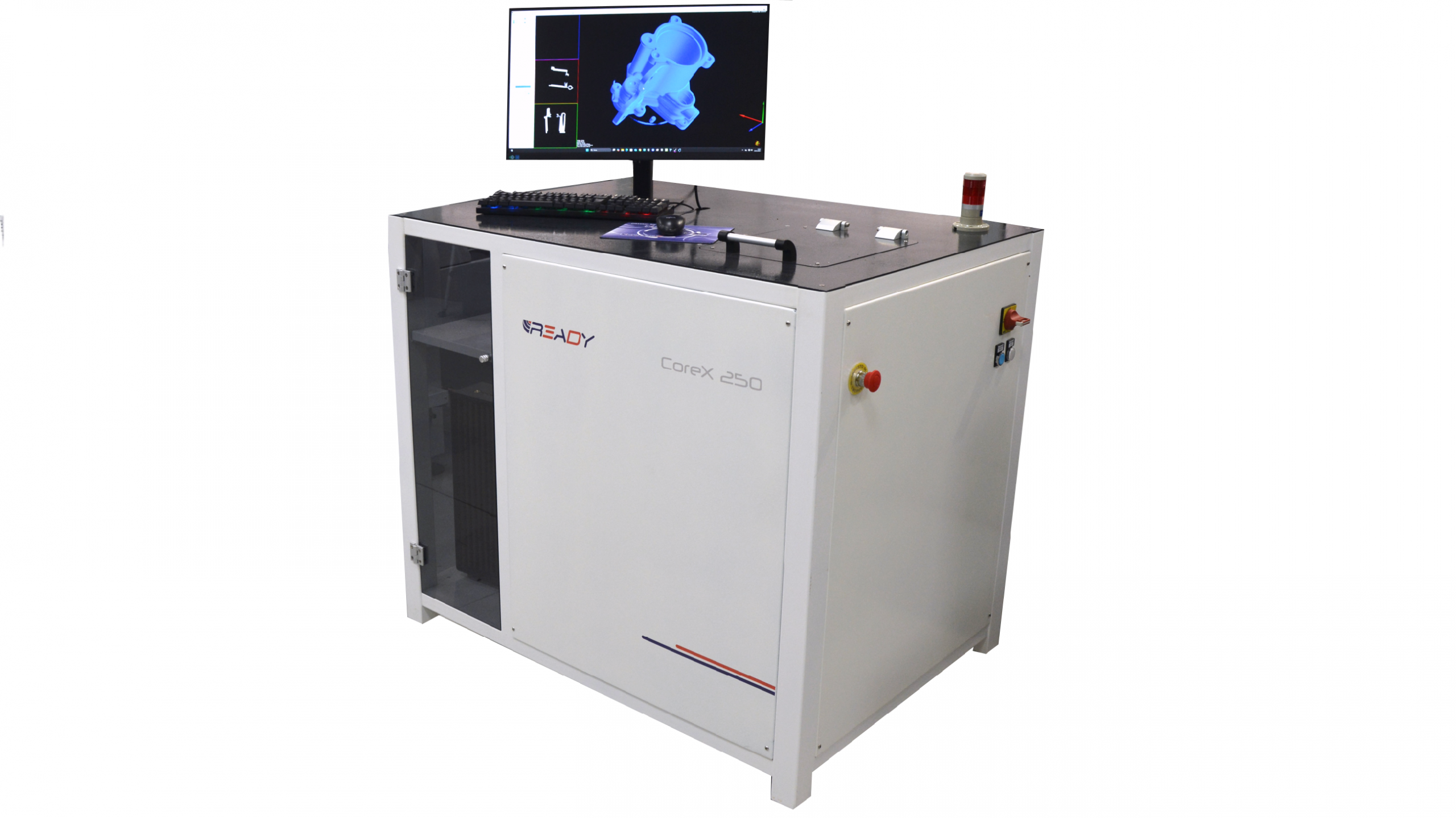

LK Metrology has introduced its innovative COREX 250 from Ready Metrology, the holding group’s brand that develops easy-to-use X-ray CT as well as CMM solutions for shop floor applications. The new industrial computed tomography system is designed for the production environment and features a 230 mm cube working volume. It brings non-contact inspection and metrology into the factory to enable non-destructive internal inspection of complex parts in seconds.
New Philosophy in Computed Tomography
Unlike traditional industrial CT systems, which are often prohibitively expensive, bulky and designed as all-purpose laboratory tools, the COREX 250 is purpose-built for the production line. While standard systems require complex setups to handle any possible part, COREX 250 focuses on specific production needs. Instead of one oversized machine, the COREX series is available in three optimised sizes. This specialisation allows for pre-defined configurations and enhanced X-ray sources tailored to the customer’s specific materials.

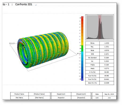

Another advantage is that the speed of inspection allows high-frequency testing. The interface features an intuitive, colour-coded histogram, allowing operators to see at a glance if parameters are centred within the tolerance band. This enables real-time process correction before scrap is even produced, guaranteeing that only good parts are delivered to the customer.
