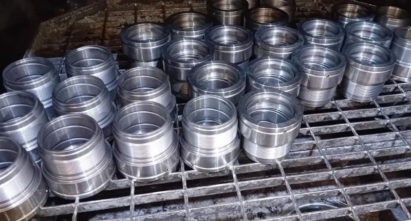

For nearly four decades, Burnside Hydracyl relied on scheduled monthly fluid changes for its cylinder washing machines. However, by early 2025, increasing customer demand for traceability and tighter cleanliness tolerances prompted Quality Engineer JJ Ryan to question the status quo.

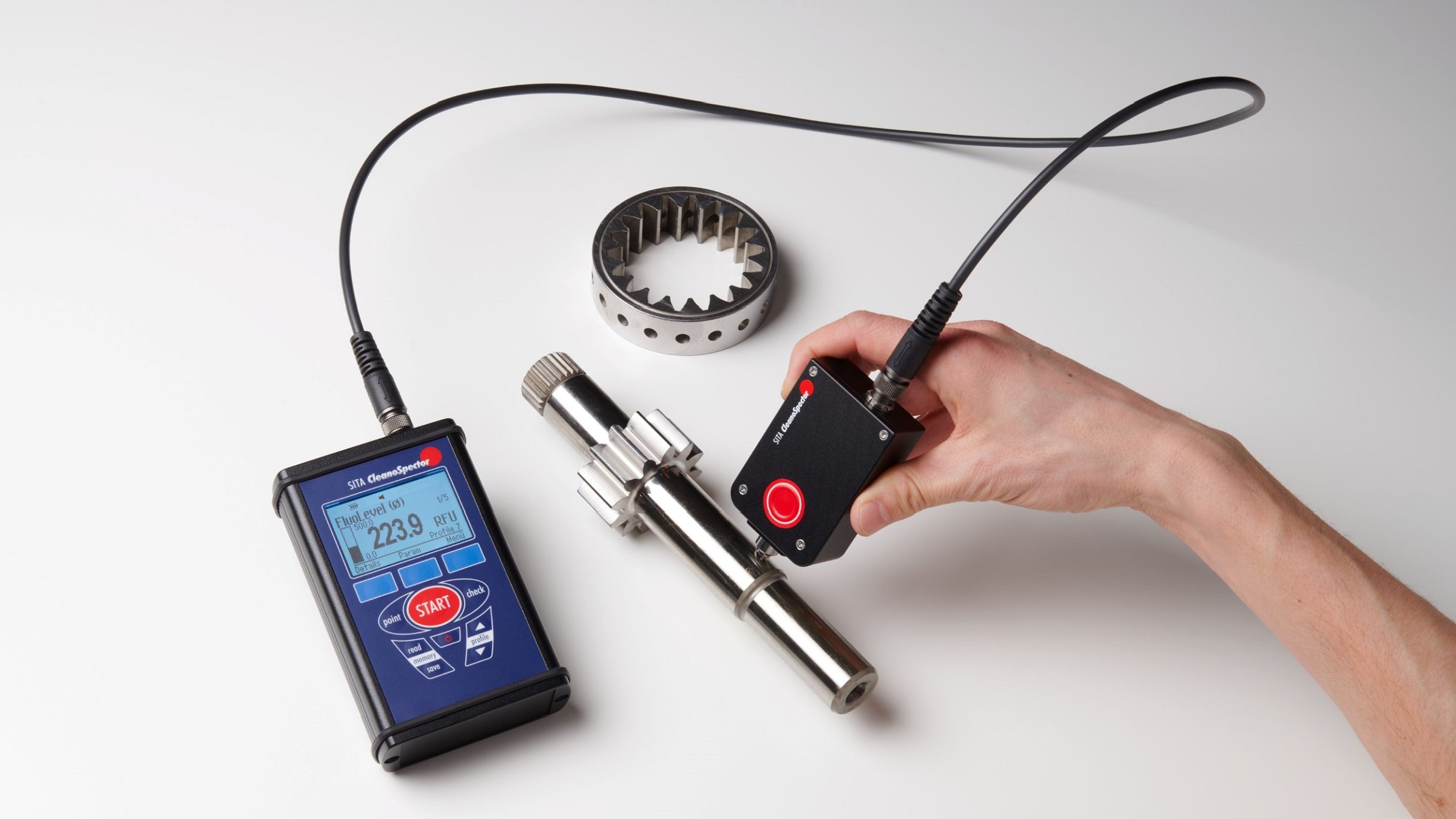

Working with Dyne Testing, Burnside trialed the SITA Cleanospector. The device utilizes UV fluorescence spectroscopy to detect residual organic contaminants. By illuminating metal surfaces with UV light, the sensor measures the intensity of the resulting fluorescence from oils, greases, and cooling lubricants.
The data is delivered instantly in Relative Fluorescence Units (RFU), providing a numerical value for surface cleanliness that allows for immediate pass/fail validation.

Since officially adopting the technology in March 2025, Burnside has transformed its maintenance workflow. Key outcomes include:
Fluid Longevity: Measurement data proved that contamination levels remained well within acceptable thresholds far beyond the traditional 30-day mark.
Cost Reduction: Fluid changes were reduced from 12 to seven per year, saving €7,500 per unit.
