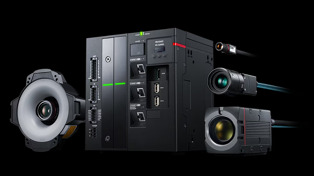

In the fast-evolving landscape of industrial metrology and automated quality control, manufacturers face an ongoing triple challenge: accelerating production speeds, increasing inspection complexity, and the growing demand for absolute product traceability. Addressing these challenges, KEYENCE has unveiled its latest innovation: the VS-G Series AI-Powered High-Performance Vision System.
Designed as a fully customizable, controller-type platform, the VS-G Series establishes a new benchmark for automated inline appearance inspection, bringing unparalleled artificial intelligence directly to the factory floor.
Next-Generation Processing – 32-Core AI Engine
At the heart of the VS-G Series features a custom-engineered 32-core high-speed processor equipped with a built-in AI engine. This processing unit delivers raw speeds up to 13 times faster than conventional vision systems (when compared to standard VS-L/S/C series platforms using a 5-megapixel AI segmentation tool).
By dedicating hardware-level acceleration to deep-learning algorithms, KEYENCE allows operators to deploy heavy-duty inspection programs – such as fine-mode AI detection and complex segmentation – without bottlenecking high-speed production lines. This eliminates the traditional compromise between inspection accuracy and high throughput rates.
Industry First – Integrated Traceability and 100x Compression
Historically, maintaining a complete visual archive of production has been logistically impossible due to data storage limitations. Manufacturers were forced to save only defective ‘NG’ (No Good) images, leaving no data trail for ‘OK’ parts.
The VS-G Series changes this paradigm by introducing the world’s first vision controller with built-in, dedicated image storage.
100x Visual Compression: Utilizing a proprietary hardware-and-software compression algorithm, the controller reduces file sizes by a factor of 100 while maintaining original image quality.
Total Traceability: This space-saving breakthrough enables the reliable, continuous storage of every single image that passes through the line, providing long-term data tracking for quality assurance audits and process optimization.
Eliminating Operator Bias via Intuitive AI Tuning
Setting up traditional vision systems often requires highly specialized expertise and tedious manual parameter tweaking. The VS-G Series democratizes this process through automated software tools.
With Auto Parameter Tuning and the Auto Image Selector, an operator simply selects a baseline target image and highlights the defect area directly on the interface. Drawing from KEYENCE’s extensive field experience in automated inspection, the system automatically calculates and deploys the optimal inspection variables.
Furthermore, a built-in Settings Verification Function allows quality managers to back-test any new configuration changes against the stored archive of historical images. This ensures that optimizing a program to catch a new defect type will not accidentally trigger false positives on historically good parts.
Versatile Applications and Scalable Hardware
To handle the diverse physical demands of modern manufacturing facilities, a single VS-G controller can scale up to support 8 independent camera connections simultaneously. KEYENCE offers an extensive ecosystem of more than 30 distinct area-scan camera models, allowing engineers to mix and match sensor resolutions and frame rates based on localized inspection tolerances.
The platform is already solving a wide array of challenging inline metrology and inspection tasks across various sectors:
Electronics & Semiconductors: Detailed appearance inspection of printed circuit boards (PCBs) and automated SEMI character reading on silicon wafers.
Automotive Assembly: Precise gap and bead tracking for automated sealant and adhesive applications.
Logistics & Material Handling: Real-time remaining-cargo and tray verification within high-density wire mesh storage systems.
With the launch of the VS-G Series, KEYENCE transitions AI vision inspection from an experimental tool into a rugged, high-speed, and deeply traceable asset built for the realities of modern factory automation.
