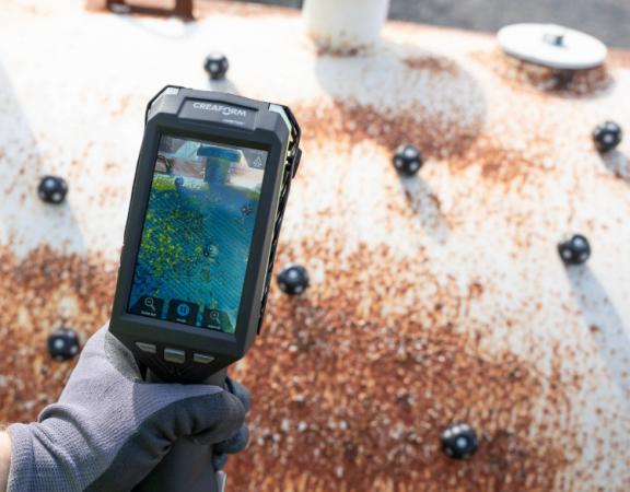

At the heart of this solution is the HandySCAN 3D|EVO Series, Creaform’s most powerful handheld 3D scanner to date. Equipped with a built-in touchscreen, the EVO Series offers intuitive, on-the-spot control for operators conducting inspections in the field, minimizing the need for additional devices and making workflows more efficient. And with the integrated Guide Inspection mode, operators can perform streamlined, preconfigured inspections directly on the scanner, with minimal steps and interaction required. Wireless capabilities, enabled by the Mobility Kit, also grant users the freedom to access and scan assets in challenging or hazardous environments, without the constraints of cables.
The integrated high-resolution 12 MP camera delivers clear, precise visual documentation, which not only supports augmented reality feedback and real-time operator guidance but also ensures high-quality reporting and traceability for critical NDT applications, without the need for an additional camera. When paired with Creaform Integrity Suite, the scanner becomes the inspection procedure itself, streamlining every step from acquisition to reporting.
