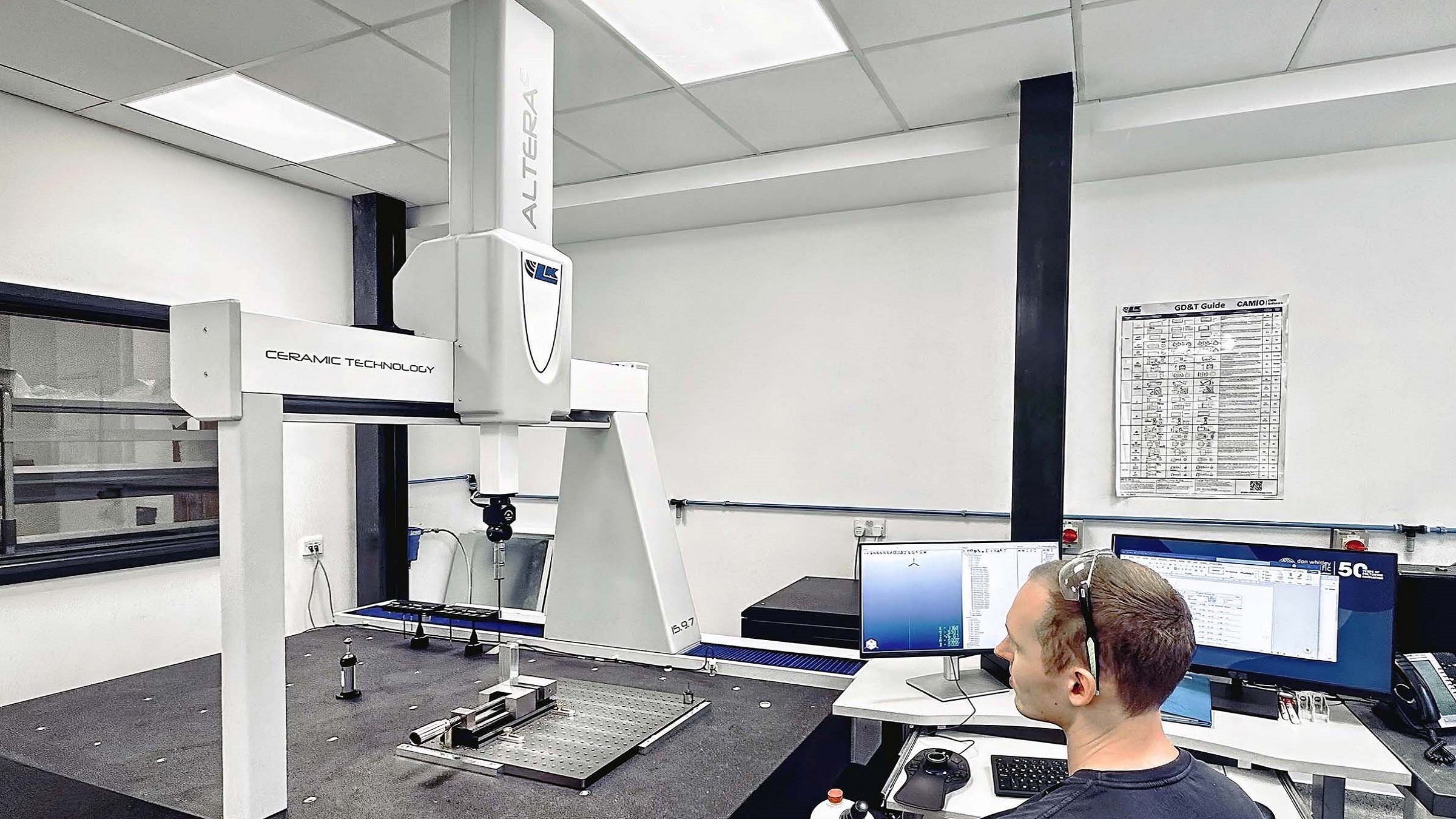

To meet this requirement, the company invested in a bridge-type Altera C 15.9.7 CMM from LK Metrology, together with the supplier’s CAMIO 2026 software. The quality department at DWS uses the CMM to verify dimensional accuracy before components proceed to production or spares are dispatched to customers, providing confidence that every component conforms to specification.
According to Fergus Murray, Director of Engineering at DWS, the business needed a CMM at very short notice to support an increasing workload and demonstrate its manufacturing capability to existing and prospective customers. Before the CMM was installed, dimensional inspection relied on manual measuring with micrometers, vernier callipers and bore gauges. Although suitable for general QC, these methods could not consistently deliver the repeatability and accuracy required for increasingly demanding tolerances. Measurement variation created uncertainty, non-conforming parts were occasionally accepted and sometimes entire production batches required rework or scrapping, resulting in wasted material and risks to delivery performance and customer confidence. As engineering standards became more demanding and project deadlines tighter, it became clear that a more robust inspection process was essential.
The introduction of the LK Altera CMM has fundamentally changed the way DWS approaches QC. Rather than relying solely on manual inspection after manufacture, components are now sampled during production, allowing process drift toward the boundaries of the allowed limits to be identified before complete batches are finished. Non-conforming stock is prevented from entering stores, while accurate, repeatable measurements provide much greater confidence in product quality before production runs are completed.
The addition of CAMIO software has enabled the business to modernise its inspection by adopting GD&T (geometric dimensioning and tolerancing). Instead of depending on linear tolerances, DWS now uses true position tolerances to achieve greater accuracy, improved part-to-part interchangeability and more reliable assembly without fitting or rework. The company has adopted the American ASME GD&T standard, which it considers more practical than traditional ISO approaches while helping to standardise inspection procedures across the business. Other benefits of CAMIO are PMI (Product Manufacturing Information) based automated programming, multi-sensor capability encompassing tactile and laser scanning, and in-line and line-side CMM automation should it be required in the future.
The operational benefits of the CMM have been substantial. Production efficiency has improved by around 30%, while scrap and rework have been reduced by approximately 90%. Material waste has fallen dramatically, contributing to more sustainable manufacturing through fewer rejected components. The company now has greater confidence in product quality due to more rigorous quality assurance before products leave the factory, as well as an enhanced capability to secure new contracts requiring very tight dimensional tolerances.
