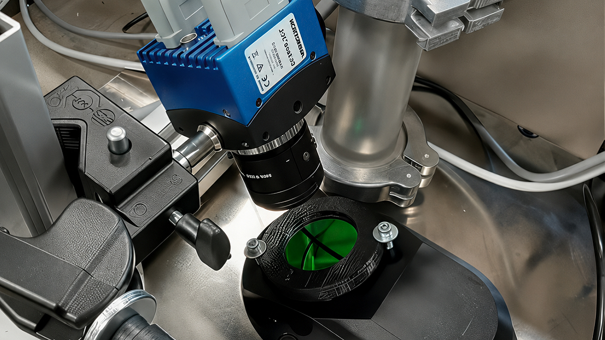

Mounted off-axis at 25° to the build plate, the EoSens 3CL camera required no alterations to the LPBF machine’s optical path. Operating at a 30 µs exposure time through a 975 nm short-wave-pass filter, the camera captured the full visible-to-NIR emission spectrum (350–975 nm) of 316L stainless steel single-track fusions across a matrix of laser power and scan speed test conditions. Each 120 Ă— 120 pixel frame covered a 12 mm Ă— 12 mm field of view at ~100 µm/pixel resolution, which was sufficient to resolve individual spatter events against the melt pool in fine detail.
From the raw video stream, the KU Leuven team extracted five classes of physics-based process signatures: process zone length-to-width ratio, process zone area, process zone mean intensity, spatter speed, and spatter count. Scan speed emerged as the dominant driver of process instability with the highest zone area and aspect ratio observed under Plateau-Rayleigh instability conditions — a defect regime associated with high laser power and scan speed combinations. Droplet spatter velocities spanned 0.4 m/s to 7.8 m/s across the tested parameter space.
The EoSens 3CL’s Camera Link interface, paired with an NI PXI acquisition system and synchronized with MCP controller data at 100 kHz, delivered the temporal and spatial fidelity needed to resolve individual spatter events frame-by-frame, at production scan speeds. The result is a monitoring solution that is machine-agnostic, non-invasive, and ready to serve as the sensing backbone for the next generation of autonomous, closed-loop LPBF control systems.
The headline finding: a strong correlation between spatter count from real-time EoSens 3CL monitoring and keyhole porosity count from post-process X-CT measurements. This result establishes a direct, quantifiable link between an optically observable surface signature and a volumetric subsurface defect without touching the workpiece. Surface topography measurements corroborated the camera-derived spatter data through cross-correlation template matching, and a validated finite element model accurately predicted melt pool geometry across multiple parameter sets.
