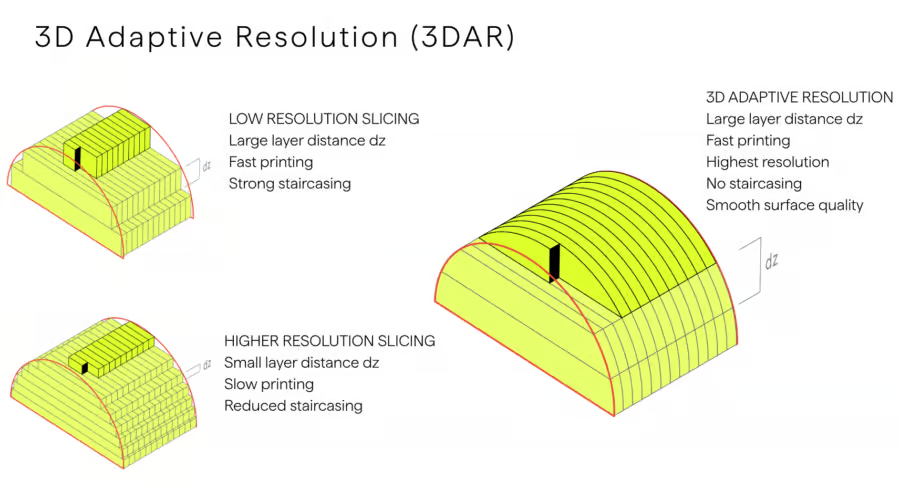

Adaptive Resolution has been one of UpNano’s core technologies since the introduction of its NanoOne printing systems. It addresses a fundamental challenge of high-resolution 2PP printing: the finer the resolution, the longer it takes to print larger structures. Adaptive Resolution solves this by changing the dimensions of the voxel created at the laser focus according to the precision required.
Until now, this essentially allowed switching between different voxel sizes: a fine voxel for delicate structures and a larger one for rapidly filling bulk volumes. 3DAR now adds dynamic control over the voxel in all three spatial dimensions.
Laser Focus Goes 3D
“3D Adaptive Resolution gives us dynamic control over the voxel in all three spatial dimensions,” says Bernhard Küenburg, CEO of UpNano. “We can continuously adapt its shape to the geometry we want to create. This allows us to combine printing speed with the surface quality required particularly for optical and photonic applications.”
3DAR builds on the established concept of grayscale lithography, which modulates the voxel size to create continuously varying height profiles. UpNano applies this principle within its 2PP process in three dimensions: the voxel itself is dynamically controlled to follow the target geometry in XYZ dimensions. This grayscale voxel control is therefore not limited to 2.5D surface topographies but can be applied to create complex, freeform 3D structures.
This becomes particularly relevant for curved surfaces. Conventional layer-based fabrication approximates such geometries through successive layers. Smaller layer heights reduce the resulting staircasing but increase printing time. 3DAR instead adjusts the voxel to the desired geometry while maintaining large layer distances. Staircasing is avoided without sacrificing throughput.

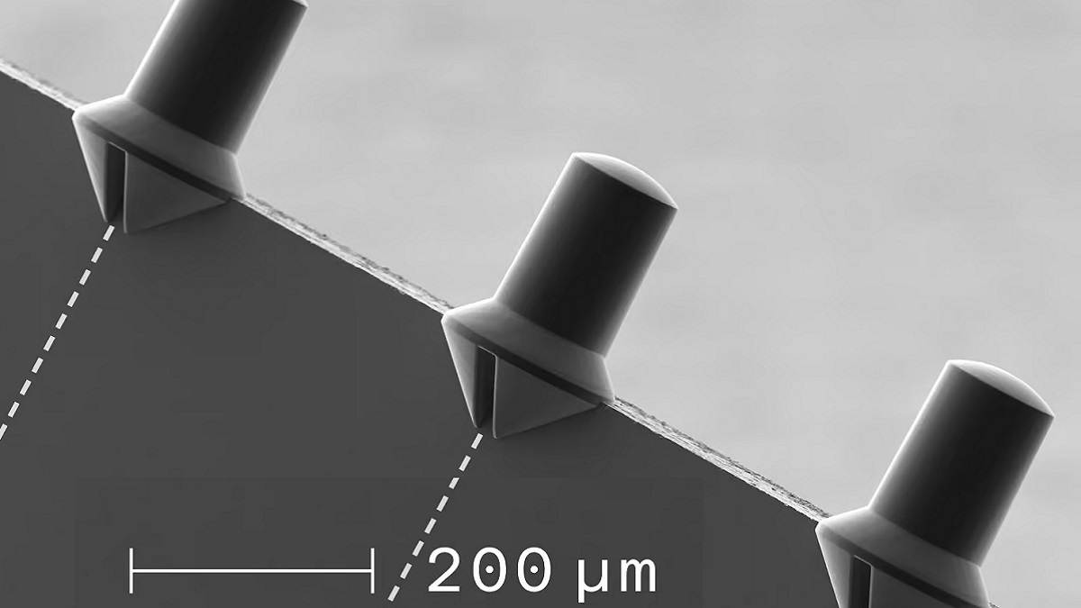

For optics and photonics, where surface quality directly affects function, the benefits are substantial. UpNano has demonstrated surface roughness down to Sq 3 nm and shape accuracy below 20 nm. Spiral phase plates with a diameter of 125 µm can be fabricated in less than ten seconds, while aspheric microscopic lenses measuring just 7 µm can be printed within two to three seconds.
Another strength of 2PP is the ability to print directly onto existing and pre-structured substrates. Micro-lenses, mirrors and other optical elements can therefore be fabricated directly on photonic chips, chip facets or fiber arrays. Automatic marker detection and alignment position the structures exactly where required.
