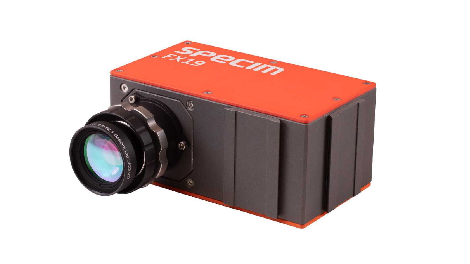

Specim, a Konica Minolta company and leader in hyperspectral imaging, has announced the Specim FX19, a high-speed push-broom (line-scan) hyperspectral camera operating in the near/shortwave infrared (NIR-SWIR) range of 1130–1920 nm. Purpose-built for industrial machine vision and advanced research environments, the FX19 expands Specim’s proven FX series, offering a blend of performance, scalability, and ease of integration that meets the accelerating demands of material identification and inspection in high-throughput applications.
The FX19 delivers market-leading performance in a compact, robust package, combining high resolution, sensitivity, and frame rates to serve precise material analysis in demanding production environments. With its modern design and flexible feature set, the FX19 is poised to bridge the gap between laboratory research and full-scale industrial deployment of hyperspectral solutions.
