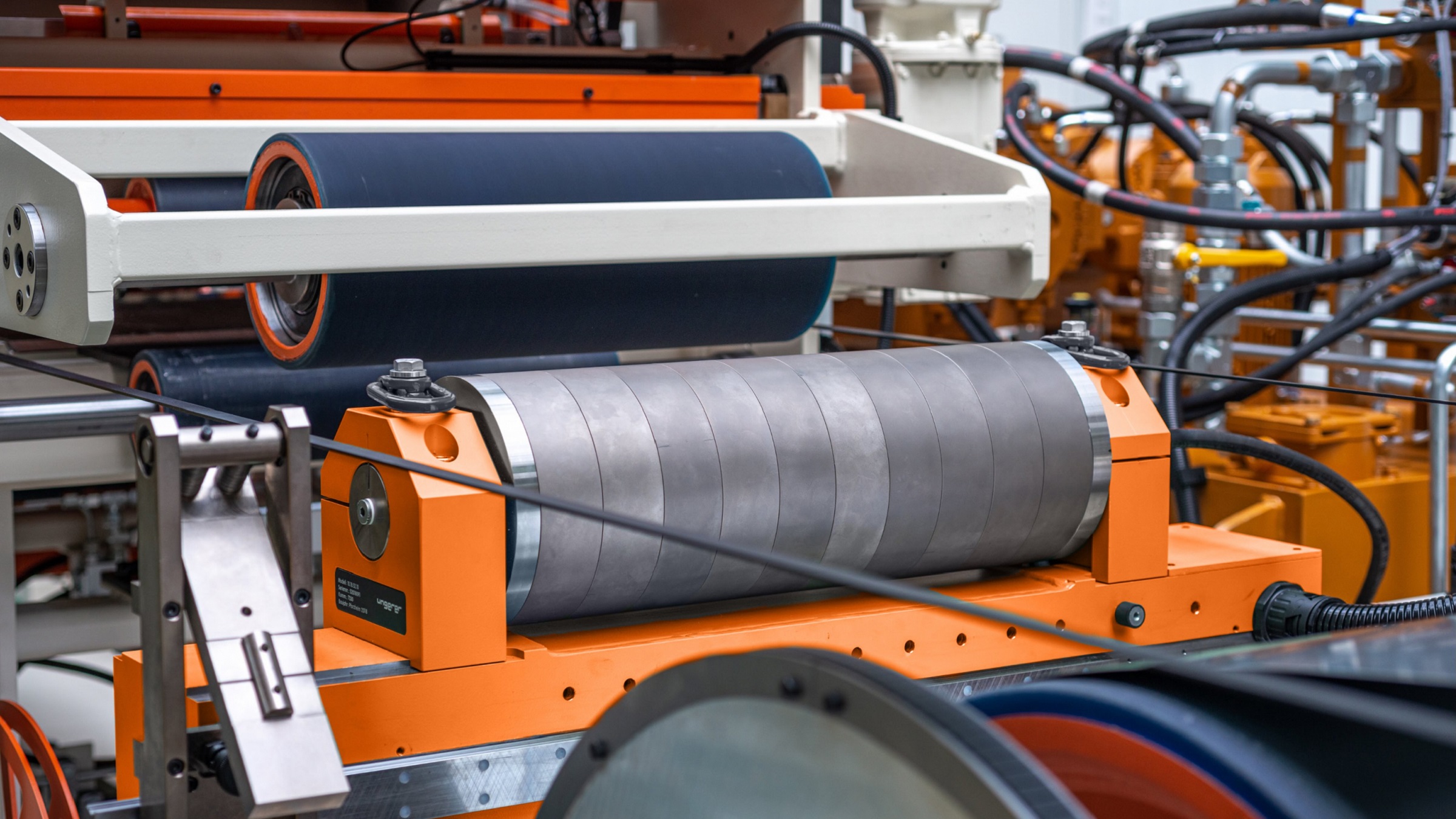

REDEX USA has announced its Unflatness Measurement System PRO, designed to improve flatness measurement and control in metal strip processing through a combination of high- and low-tension measurement technologies. The system achieves stated measurement accuracy of up to 99.5% at the line exit and incorporates an integrated REDEX controller to enable immediate flatness correction downstream of the leveler.
Accurate flatness measurement is essential to the production of high-quality rolled metal products, where variations in strip geometry can affect downstream processing, material utilisation and finished component quality. Measuring flatness under different tension conditions provides a more comprehensive assessment of strip behaviour throughout the production line.
The UMS PRO system uses two measurement stages. In the S-Block zone, the UMSi seamless roll measures strip flatness under high tension, achieving approximately 98% measurement accuracy. At the line exit, a UMS-LT roll performs a second measurement under low-tension conditions, with accuracy of up to 99.5%.
