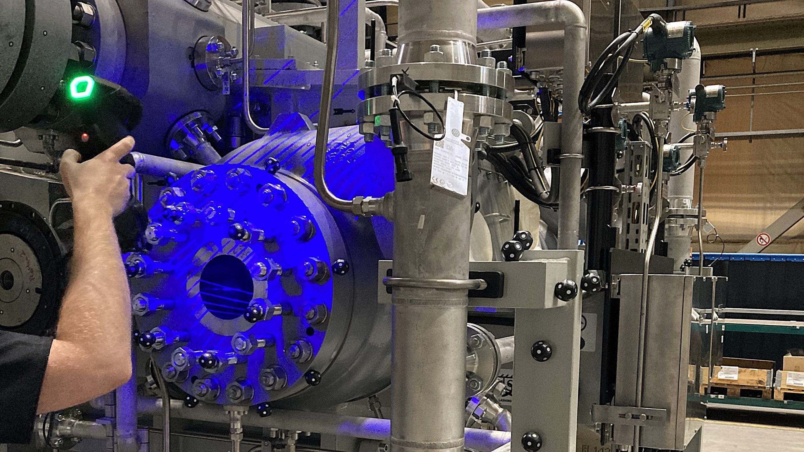

Accuracy: Because of the machine’s large dimensions—approximately 3 m × 3 m × 3 m—a combination of photogrammetry and 3D scanning was required to achieve high accuracy across the entire assembly. The solution also provided the flexibility to scan large components quickly and efficiently from a longer distance using the Far Mode, which limited the number of targets, while the Near Mode allowed for the capture of smaller areas with fine detail and resolution. For medium-sized components, the Scale Bar Mode offered an effective alternative to photogrammetry, maintaining accuracy while further simplifying the workflow.
Portability: Thanks to its ergonomic, handheld, and portable design, the solution could be used flexibly both in the factory and on site at customer facilities. Measurements were not limited to the designated measuring station but could also be performed directly in various assembly areas. This mobility was particularly valuable when certain surfaces were difficult to access due to complex piping layouts or spatial constraints.

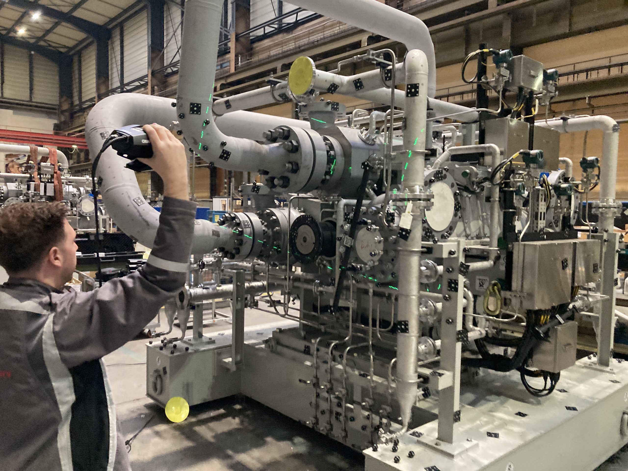

Everllence operator performing large-scale dimensional inspection of an industrial machine using the FARO CREAFORM MaxSHOT 3D, with photogrammetry targets distributed across the structure for high-accuracy measurement.

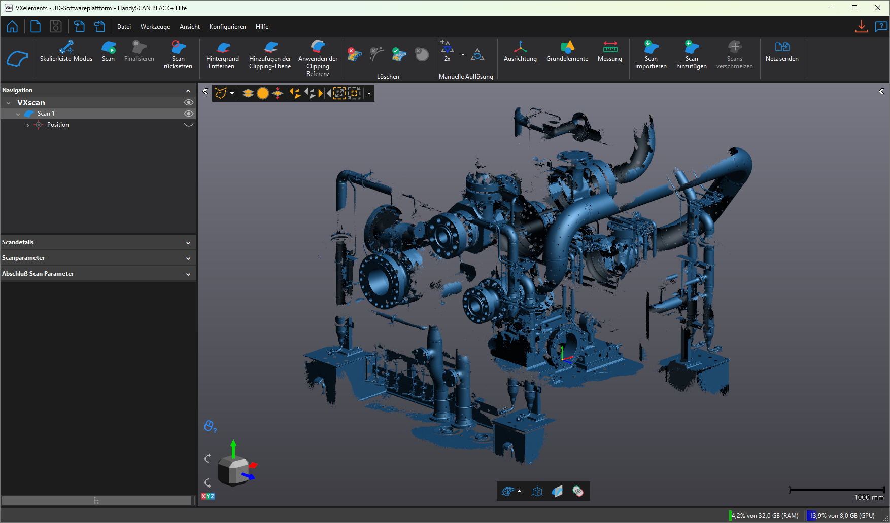

3D scan of a large industrial machine assembly captured by Everllence using the FARO CREAFORM MaxSHOT 3D and visualized as a full digital mesh model in the Creaform Metrology Suite.
