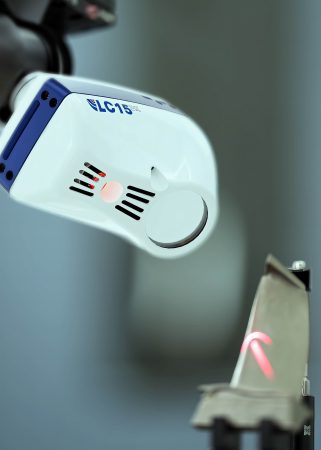

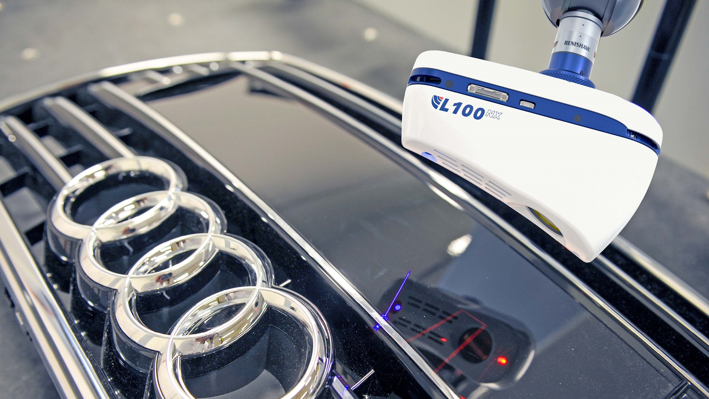

Engineered for automated dimensional inspection and 3D surface digitisation, the non-contact sensors enable manufacturers to inspect complex freeform surfaces, intricate features and delicate components far more efficiently and rapidly than is possible with traditional touch-probe measurement techniques. The newly-introduced, Ethernet-ready lineup is comprehensive, as it incorporates the LK Metrology LC15DX, L100NX and SLK25 line scanners models as well as the XC65DX and XC65DXLS cross scanners.
To ensure seamless deployment, the same high-performance specifications as in the previous SDI (Serial Digital Interface) technology scanners has been maintained, providing customers with identical, high-accuracy measurement alongside modern data transmission capabilities. In addition to the laser scanning heads themselves, the launch includes an intelligent sensor interface controller. Available in both standard 19-inch rack-mount and desktop configurations, they enable LK to retrofit CMM laser scanners to many popular brands of CMM while retaining the original CMM controller.

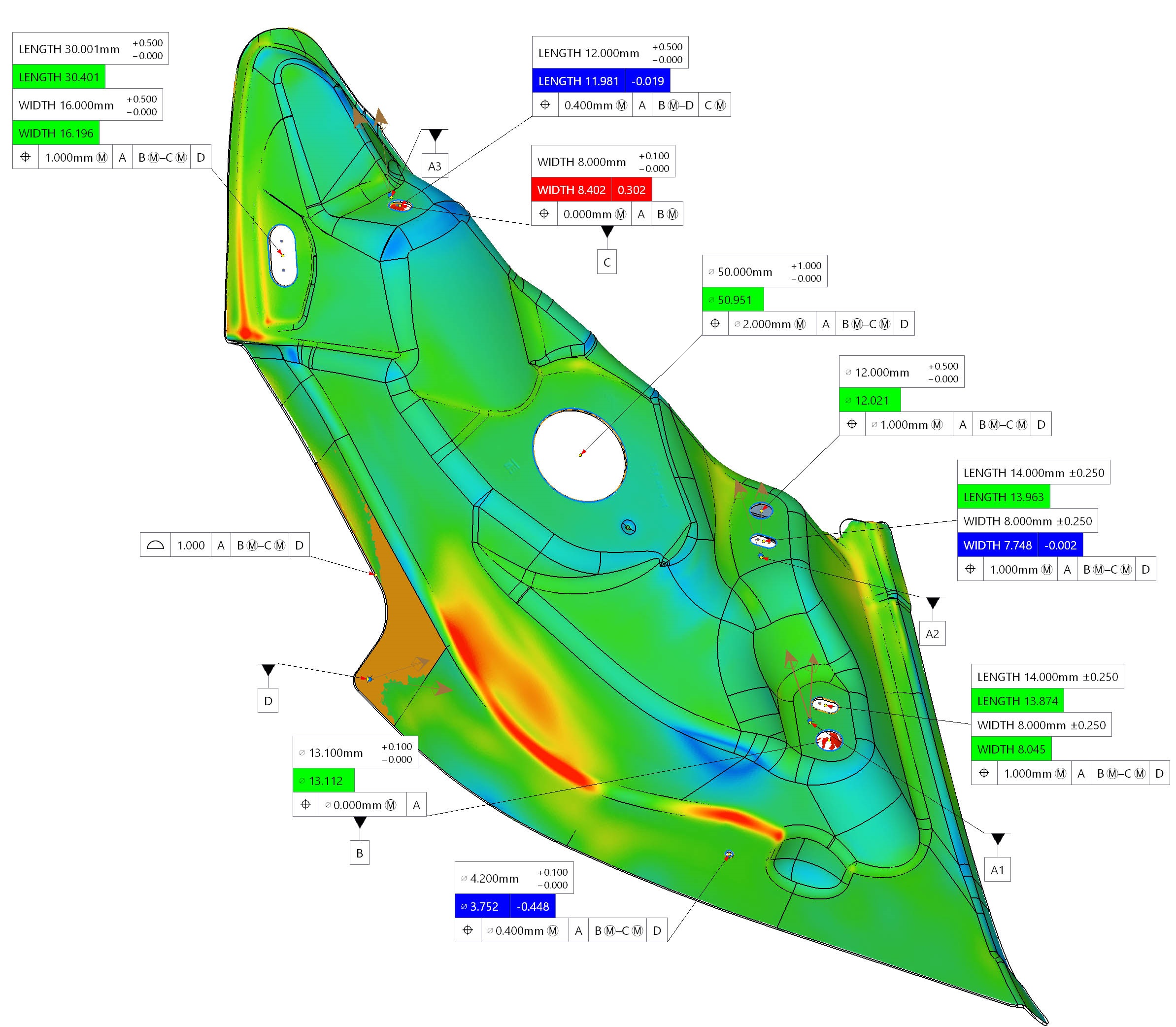

Complementing the new hardware, LK Metrology’s FOCUS point cloud inspection software streamlines part-to-CAD inspection by automatically comparing scanned point cloud data with nominal CAD geometry. Deviations are visualised through intuitive colour maps and detailed graphical reports, enabling fast and reliable assessment of part quality.
Precise inspection of feature locations, dimensions and geometric characteristics ensures components conform to design intent, helping to guarantee proper fit, assembly performance and product reliability, while minimising manufacturing errors and costly rework.
