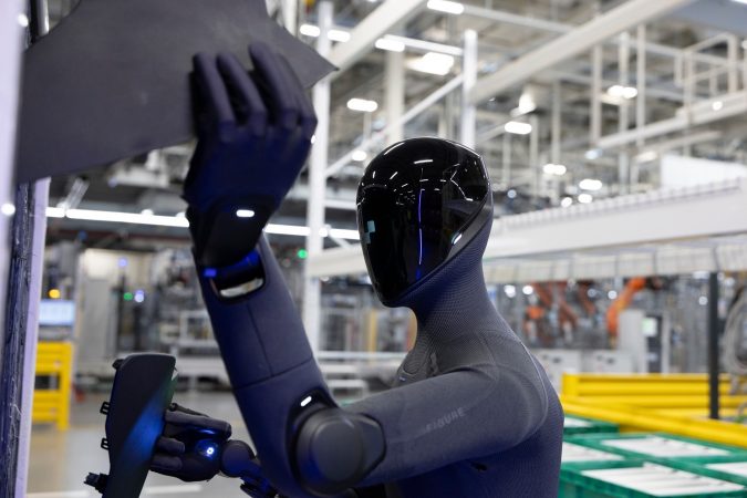

The BMW Group already gained important experience with humanoid robotics at Plant Spartanburg in 2025. In collaboration with the technology company Figure AI, the Figure 02 robot supported the production of more than 30,000 BMW X3 vehicles over ten months. In the body shop, the robot inserted sheet-metal parts for the welding process – a task that demands high speed and accuracy and can be physically demanding.

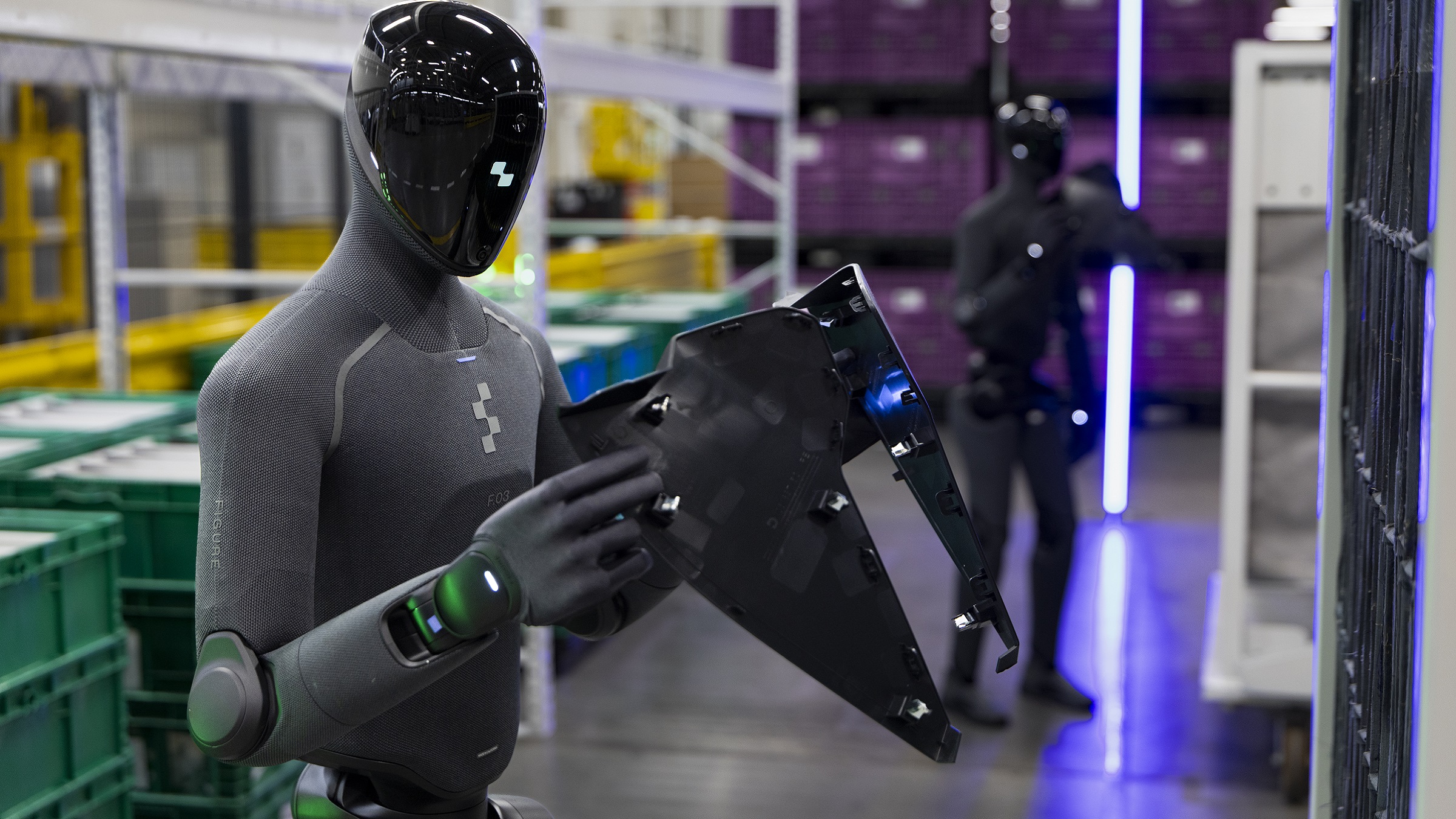

The findings gained from this project form the basis for the next step with the successor model, Figure 03. “The robot introduces several new features for expanded applications. These include soft components designed for enhanced safety, wireless charging designed for higher availability and audio functions for speech-to-speech communication, along with improved hands with tactile sensors and palm cameras designed to increase precision and dexterity,” explains Adcock.
In the new sequencing use case application, delivered components initially arrive in larger containers, unsorted. Figure 03 will pick them up and sort them into a sequencing trolley. The trolley will then be taken to a defined collection point for onward transport. An automated tugger train or a Smart Transport Robot will then transport the parts to the installation location, where they will be provided to assembly employees ‘just in sequence’. This use case occurs frequently in automotive production logistics and offers potential for further development and scalability.
