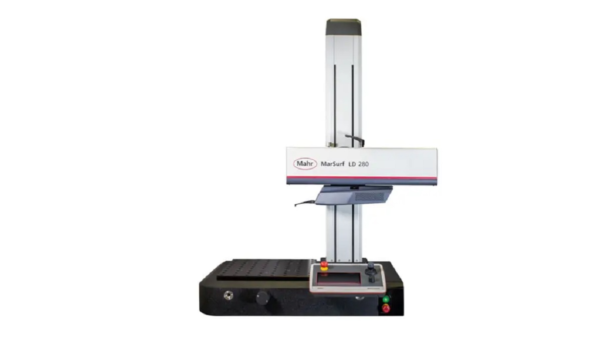

Mahr Inc., a leading provider of dimensional metrology solutions, has announced the new MarSurf LD 280, an innovative measuring station that provides an automated solution for obtaining roughness and contour measurements with maximum accuracy. Its unique probe system can simultaneously evaluate contour and roughness features with only one measurement.This saves time and cost, as two measurement result types are obtained with a single run, and users need to invest in only one measuring station.
Using the stylus method, the MarSurf LD 280 measures workpiece roughness, contour, and waviness. It is available with a manual or motorized TY-axis (for part crowning or positioning), a motorized Z-axis at two heights (350 or 600 mm), and an X-axis at two lengths (140 or 280 mm), creating eight device variants with different degrees of automation for tailored solutions. The comprehensive portfolio of probe arms also qualifies the MarSurf LD 280 for a wide range of diverse measuring tasks.
The MarSurf LD 280 is ideal for evaluating a wide range of tolerances due to its highly accurate reference datum.

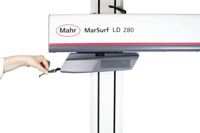

In addition to its versatility, the MarSurf LD 280 is a future-proof, state-of-the-art investment. The device has extremely fast and precise positioning axes, and thanks to the large flexible grid plate, clamping positions are reproducible, which shortens set-up and overall cycle times. Furthermore, the probe arm unit can be easily changed without tools, as it is magnetically attached to the probe system. A chip integrated into the probe arm ensures that the software recognizes the probe arm without confusion, and the probe force is set automatically. After changing probe arms, the user does not need to perform a probe recalibration. Calibration data transfers between probe arm changes.
