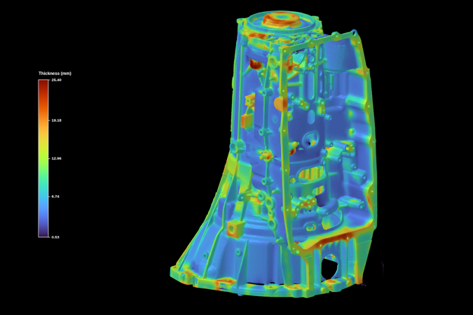

Wall thickness analysis of a transmission case. The color scale shows thickness in millimeters, with cooler colors marking thinner regions and warmer colors marking thicker sections.

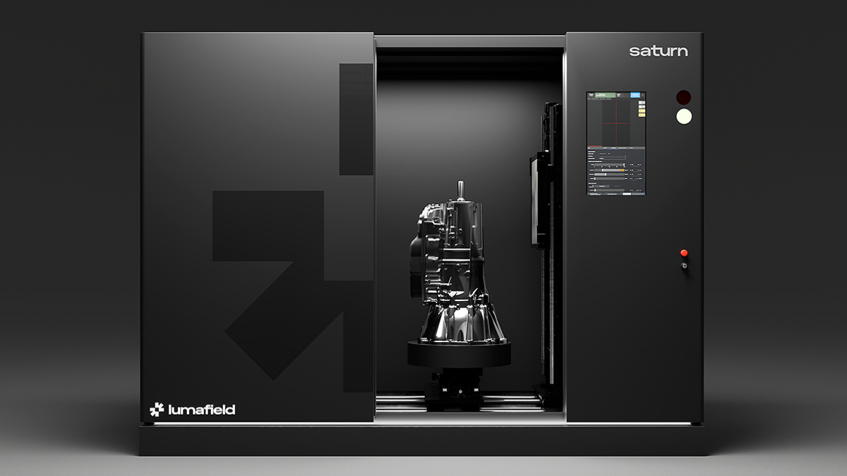

Saturn makes it straightforward to inspect critical components with full internal visibility. Large parts can be scanned in their entirety, so teams can evaluate internal quality elements like porosity, wall thickness, bonds, and welds that are often hidden or only partially revealed by sample-based or sectioned inspections. Key technical highlights and capabilities include:
Larger Scannable Volume: Saturn delivers the largest scannable volume of any Lumafield scanner, supporting helical scans of parts up to 580 mm in diameter and 1,100 mm high. It can accommodate full transmission cases, engine blocks, and structural assemblies without disassembly. It fits through a standard double door without requiring expensive facility modifications or special access.
Easy to Use: Auto-scan feature means users don’t need a CT technician to operate Saturn and obtain high-quality data. Team members can get trained in a single day to use Saturn.
Zero Maintenance Required: Saturn is powered by a closed-tube X-ray source that eliminates routine upkeep. The scanner is backed by annual servicing from Lumafield, so teams can operate without needing any maintenance knowledge or expertise.
Advanced Imaging: Lumafield’s sophisticated reconstruction and processing workflows—including offset, helical, as well as combined offset and helical—comes standard with Saturn.
High-Energy Metal Penetration: Equipped with a 225 kV high-energy X-ray source, Saturn penetrates dense materials, including up to 100 mm of light metals such as aluminum and magnesium and up to 25 mm of heavy metals like steel and iron.
Automated Cloud-Based Analysis: Seamlessly integrates with Lumafield’s cloud-based Voyager software, and supports Autoscan, full-height radiographs, batch scanning, and automated defect detection. High-value metal components with demanding performance needs can also be validated with Voyager’s dimensional analysis tools.
