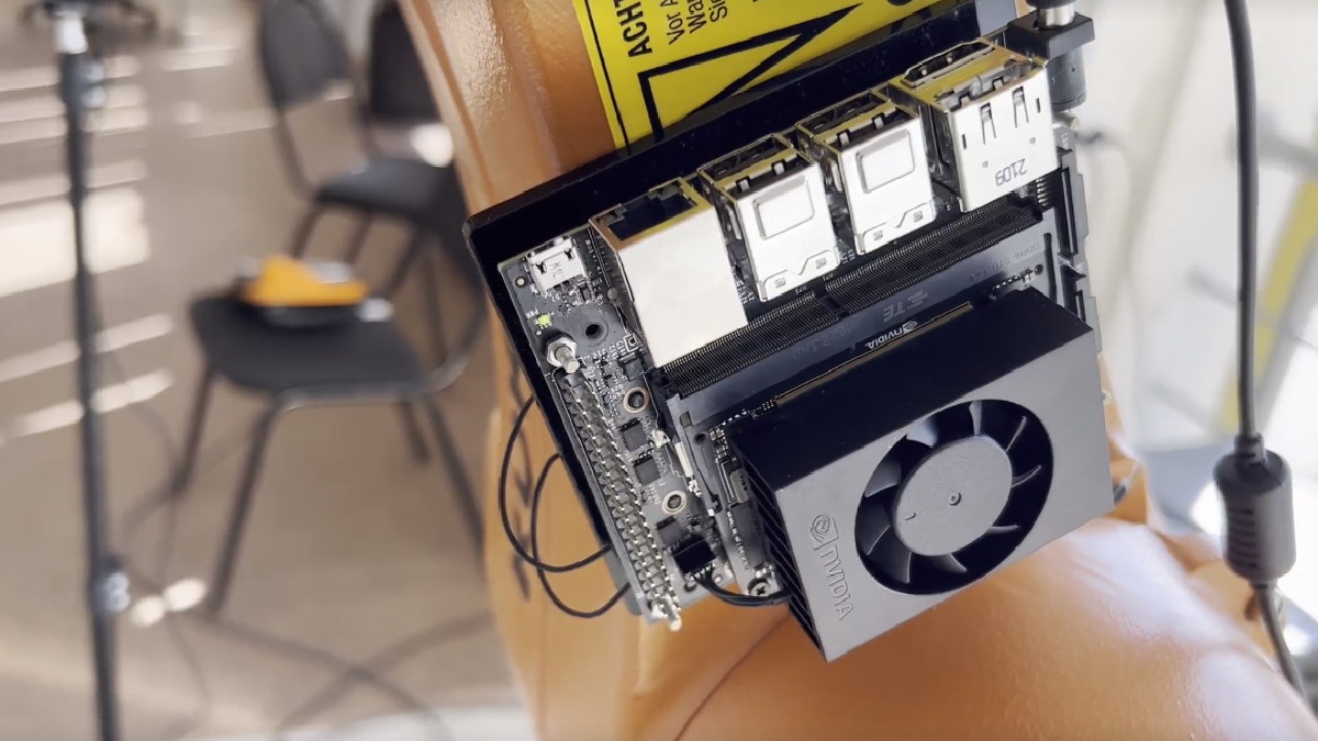

A key feature of the TwinBox is its ability to function effectively without the need for a mouse, keyboard, and monitor. It solely requires network interfaces to seamlessly connect to an internal network and a robot control system. This allows users to save more of their valuable floor space while still being able to utilize the full suite of features that RoboDK has to offer.

With TwinBox, RoboDK has crafted a reliable system that runs on both industrial and consumer-grade hardware. It supports multiple operating systems and hardware architectures, including Windows and Linux Debian or Ubuntu running on Intel x86-64 platforms or ARM. RoboDK provides dedicated builds for systems such as the Nvidia Jetson or Raspberry Pi-based industrial computers.
