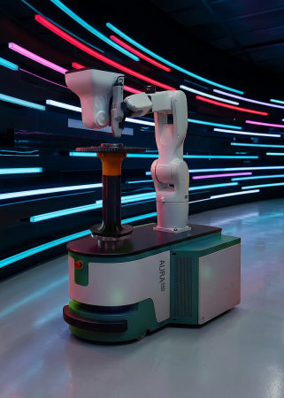

The Optimax AURA K4D is the first automated inspection system of its kind to combine two industry-leading technologies — the Kitov CORE+ and the 4D InSpec Surface Gauge — within a single integrated platform. The system recently made its debut at the MACH 2026 exhibition in the UK, where it attracted significant attention from manufacturers and quality professionals.
Identity, Characterise, and Measure
The AURA K4D’s defining USP lies in its ability to identify, characterise, and measure within a single automated closed-loop process, a world-first for an instrument of its kind. Once the system flags a flaw, it characterises it against prescribed tolerances. Where quantification is required, the system automatically switches to the optical precision head without operator intervention, eliminating the risk of subjective judgment.

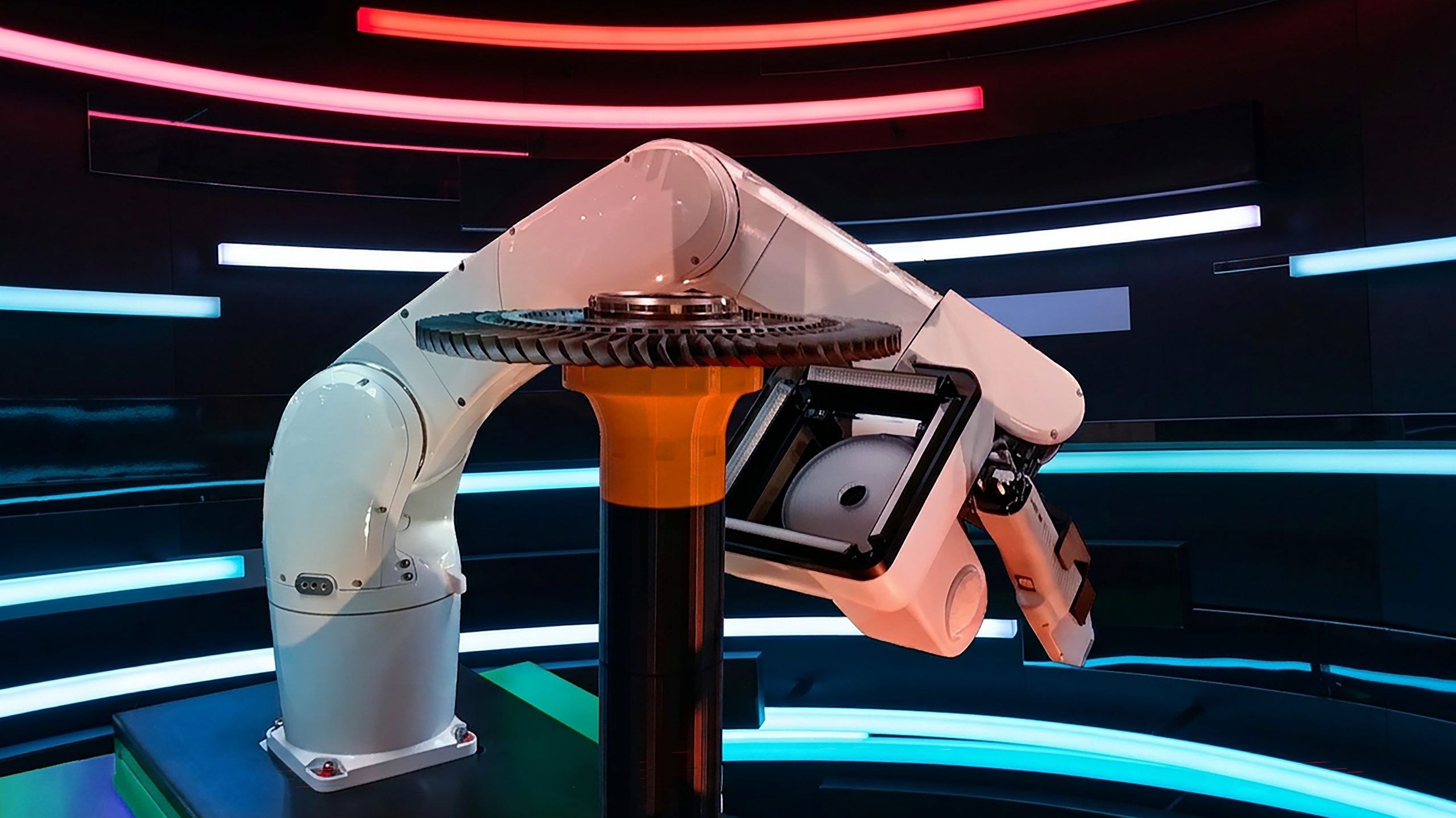

The Kitov CORE+ serves as the AURA K4D’s brain and body. Featuring a high-speed, 6-degree robotic arm and a rotating table, it can manipulate and inspect complex geometries up to 800mm in diameter and 40kg in weight.
Using CAD2SCAN software, the system automatically generates inspection plans directly from CAD files or through deep learning. By combining traditional 2D and 3D machine vision with Artificial Intelligence and Deep Learning (AI/DL), the AURA K4D identifies defects that standard sensors frequently overlook, including pits and scratches, nicks and dings, and machine marks and burrs.
