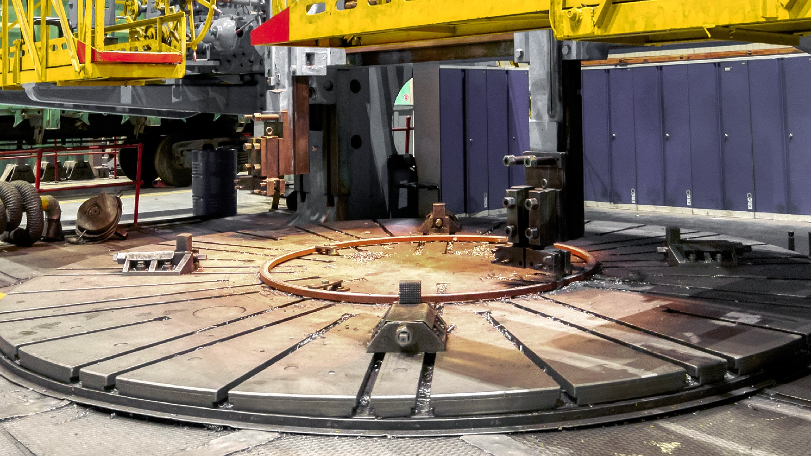

Longer FORTiS enclosed encoder scales can help to optimise the performance of these large machine tools. VTLs handle massive workpieces, often several metres in diameter. Precision motion control and closed-loop position feedback is important when creating intricate contours or critical features that require multiple motion axes to be carefully interpolated together.
Longer FORTiS encoder scales are particularly valuable for dual ram systems as both turning heads can use the same scale, which simplifies mechanical design and improves machining quality. With customers increasing their requirements for higher precision whilst controlling costs, the FORTiS linear encoder meets these demands due to its high performance and durability.
