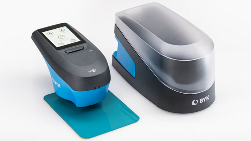

BYK-Gardner USA, partner of the automotive, paint and plastic industries for quality control of color, appearance and physical properties,  has introduced the new color2check, a portable spectrophotometer that offers a simple and affordable start to color quality control. The instrument complements the newly introduced color2go and expands BYK‑Gardner’s portfolio of portable spectrophotometers to meet customer needs, ranging from basic entry-level use to professional applications.
The color2check features a lightweight and rugged design with horizontal alignment, making color and gloss measurements simple, stable, and secure. Its 2.8-inch color touchscreen with icon-based menus, clear data tables and graphical displays ensures intuitive operation. ‘Touch and swipe’ can be used as on a smartphone, even when wearing gloves, enabling efficient use in laboratory, production, or field environments. To ensure long term protection, the instrument is delivered with a dedicated garage. When not in use, the color2check can be safely stored to protect it from dust. The garage also provides space for the test standard box so that it’s always close at hand.
The color2check focuses on reliable color measurement and represents a practical solution for customers who do not require gloss measurement and are satisfied with wider specifications. Digital standards cannot be exchanged, meaning physical working standards must be measured as a reference with every color2check. This makes the instrument well suited for internal quality control tasks with less stringent specification demands. The instrument benefits from proven BYK LED illumination, providing excellent short term, long term, and temperature stability. No calibration is required for up to three months, and the LED light source comes with a 10-year warranty, eliminating the need for lamp replacement during the instrument’s life.
