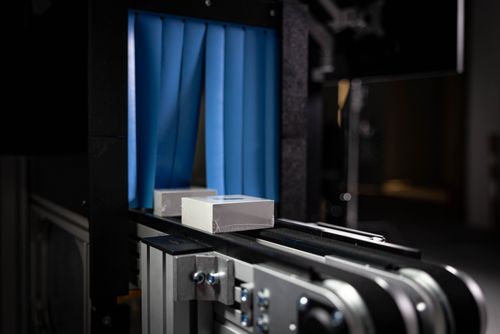

Lumafield has announced the launch of Mars, its high-speed in-line arrayed X-ray system designed for manufacturing environments where throughput and total quality oversight are critical. Purpose-built to integrate directly into existing production lines, Mars inspects every part at full conveyor speed, eliminating the need for complex fixturing or production flow interruptions.

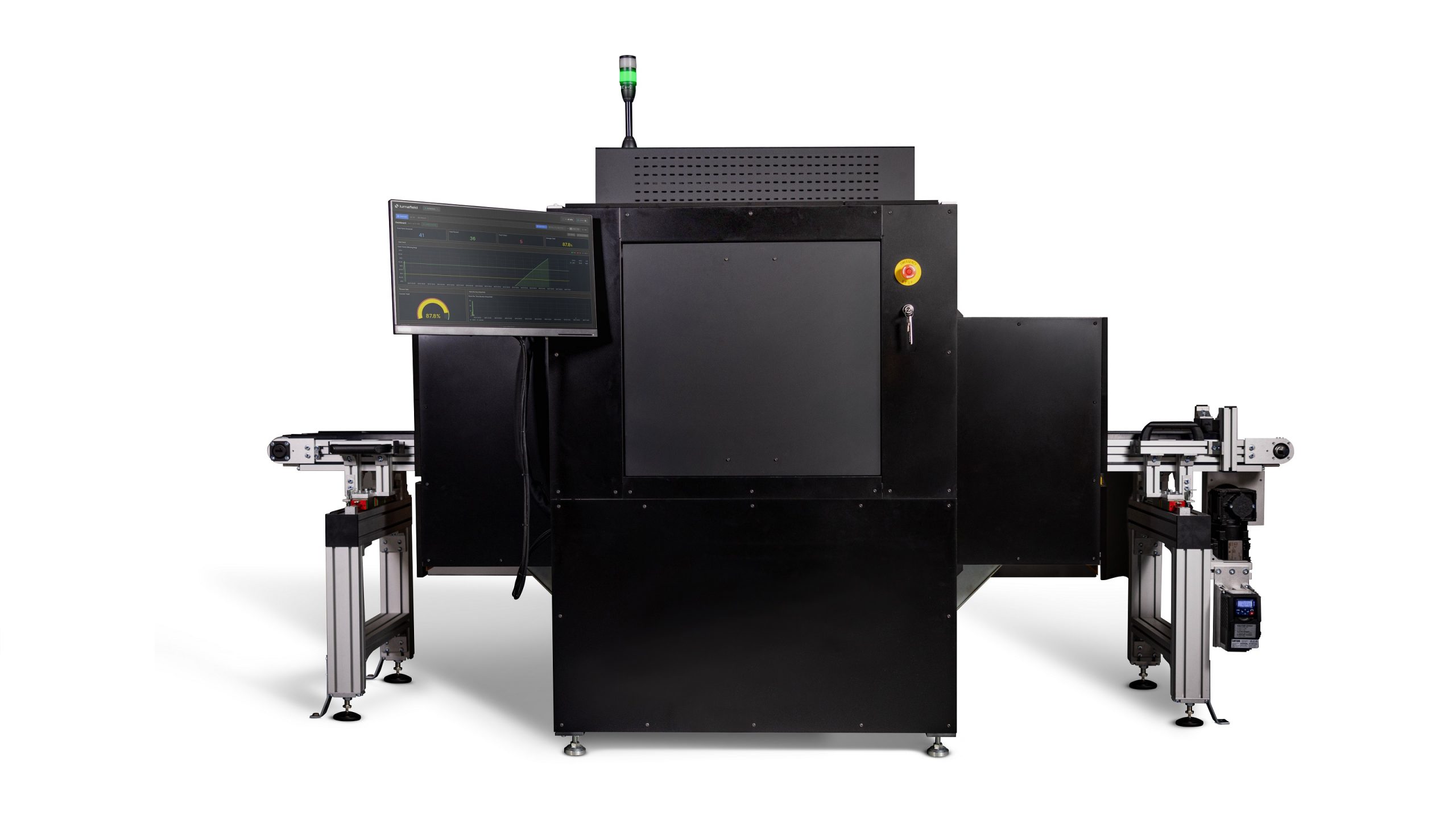

Mars changes the equation by maintaining maximum line speed while delivering robust inspection capabilities. Key technical highlights and benefits include:
Production-Speed Performance: Mars reaches inspection speeds of up to 2.5 ft (760 mm) per second, keeping pace with the most demanding, high-volume manufacturing environments.
Advanced 2.5D Architecture: Mars is available in both 2D and 2.5D arrayed configurations. The multilinear 2.5D architecture captures critical depth information in a single pass, providing richer defect visibility for challenging applications.
Flexible Hardware Integration: Configurable module with integrated conveyor or a wrap-around integration that installs over your existing conveyor. Source and detector configurations can be adjusted for overhead or side-view scanning depending on how parts are presented on the line.

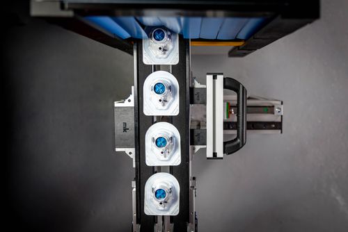

Automated Sorting & Rejection: Configurable sorting and rejection options give teams control over how flagged parts are handled downstream.
Seamless Line Integration: Compatible with all major PLCs for easy integration.
