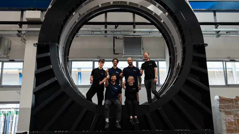

GiantEye, a globally unique high-energy CT system will go into operation in early 2027. The gantry system enables non-destructive 3D inspection and digitization of objects up to the size of a 20-foot sea freight container. Unlike its predecessor system, test objects are scanned in ‘road position’. Industrial customers can use the system for individual measurements or entire measurement campaigns and receive detailed 3D volume data with professional evaluation by the team of the Development Center for X-ray Technology.
GiantEye is a gantry-based high-energy (9 MeV) CT system whose design principle is modeled on clinical CT scanners – but on a scale capable of accommodating large industrial objects. In this setup, the test object remains stationary in its natural position, standing or lying, while the X-ray source and detector rotate together around the object on a ring-shaped structure. The technical design of the system is consistently geared toward large-volume industrial inspection.
