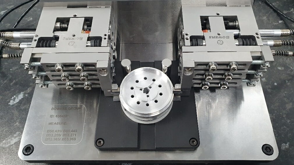

Virtue Aerospace’s specific product had a 0.016mm total tolerance that requires 100% inspection to confirm compliance. The previous method of measurement was undertaken by a CMM machine and whilst the measurements were accurate, they were both time-consuming and costly.
The solution that Bowers Group provided has transformed measurements by enabling the simultaneous assessment of three tight tolerance diameters, providing multiple benefits that enhance efficiency and productivity.
Since installing the system, inspection time for the part has significantly improved, falling from 3 minutes carrying out the measurements on the CMM, to just 15 seconds with the newly implemented measurement system, resulting in an impressive 91.6% reduction in inspection time.
A key advantage is the straightforward setup of the system, featuring a user-friendly interface that reduces preparation time and maximises efficiency. Simultaneous measurements have helped reduce inspection time, and the system has been engineered for reliability, ensuring consistent and accurate results.
