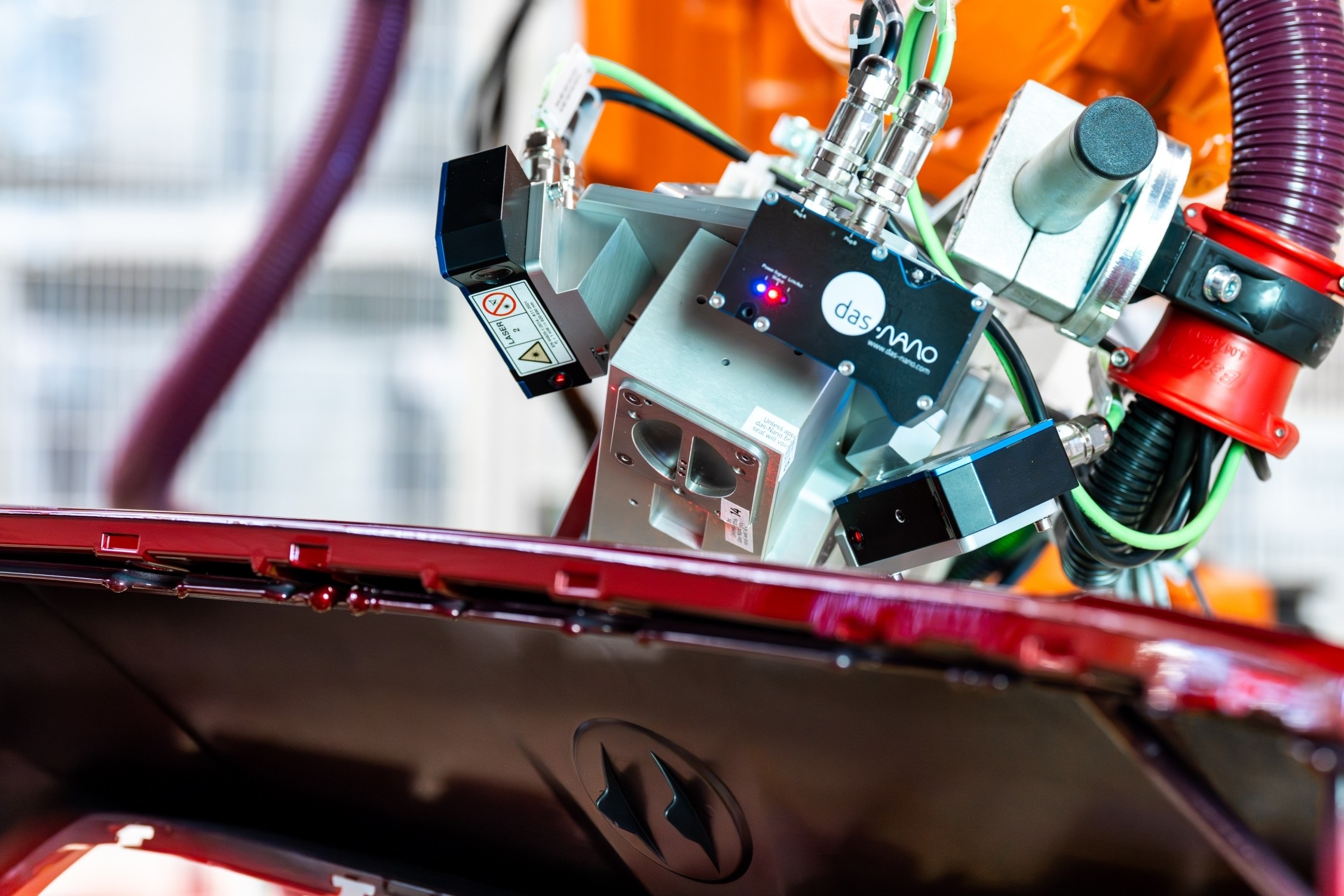

At the heart of the innovation is the terahertz measurement system ‘Irys’, developed by technology partner das‑Nano specifically for industrial inline inspections. The system enables contactless, non‑destructive measurement of multi‑layer paint systems and delivers real‑time data, representing a significant advance over previous inspection methods.

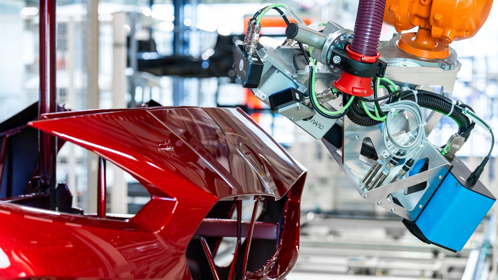

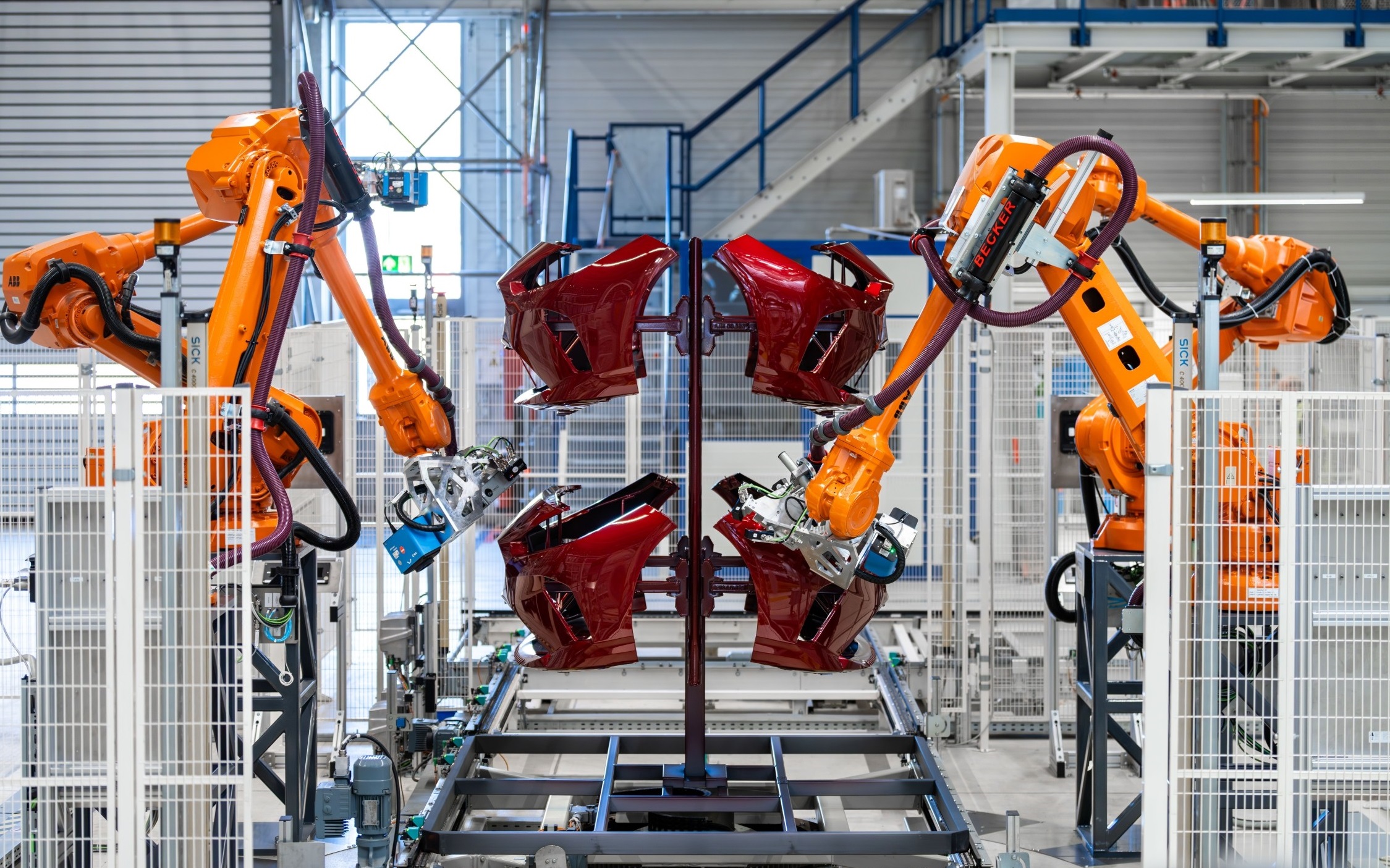

Terahertz technology fundamentally transforms this process: sensors mounted on two robots in the existing end‑of‑line measurement cell are automatically and precisely positioned in relation to the component, where they measure the thickness of the individual paint layers by analysing the time‑of‑flight of reflected terahertz waves. Measurements take only seconds and achieve accuracy down to the micrometre level.

Following successful piloting and ramp‑up, the new technology can now be deployed with all component carrier systems, or ‘skids’, and is currently being enabled for all colour variants as well. It also offers significant potential for rollout at other plants, particularly in painted body shops and across the supplier network.
