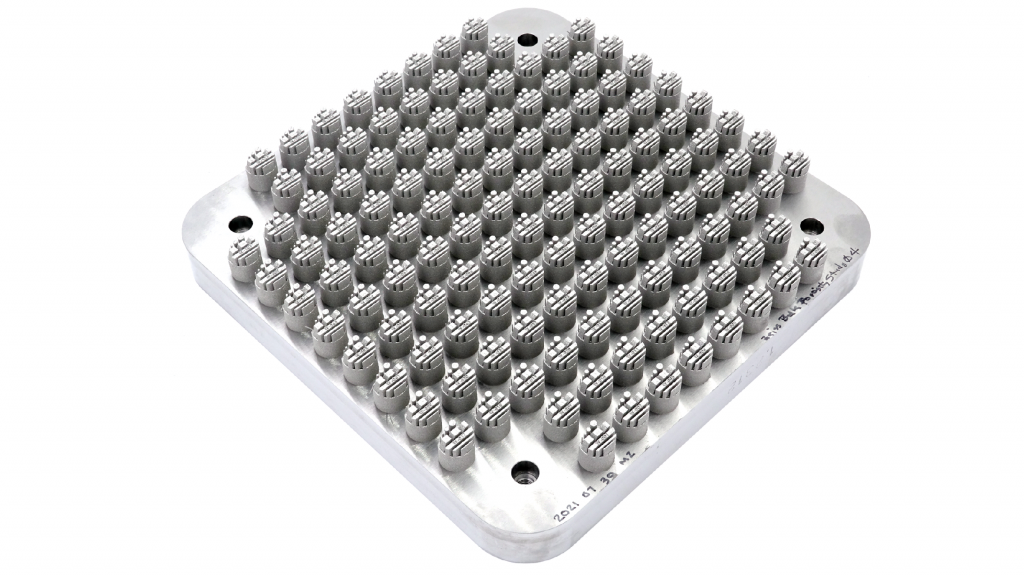

Parameter development for metal AM typically requires printing multiple coupons, each printed with a combination of print parameters to evaluate the best set of parameters to print with, in order to minimize defects (porosity, cracks), deformation and smoother surface finish.
ZEISS AM parameter provides a fully automated, fast and reproducible evaluation of porosity, pore morphology and geometric deformation of the entire build plate of coupons in a single build.
