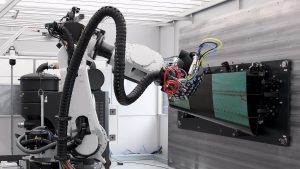

The customized, low-emissions solution integrates voxeljet’s high-speed VX1300-X (VJET-X) 3D printers into a fully automated pre- and post-processing workflow, including industrial microwaves for curing the 3D printed cores. Printing rates were increased by factor ten with the latest generation of VJET-X 3D printers, and the toolless design of the sand cores allowed for variant changes at unprecedented speed without time-consuming tool changes and production downtime. The unused material is 100% recycled and reused in the production process.
