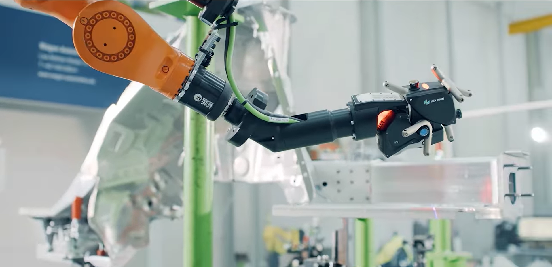

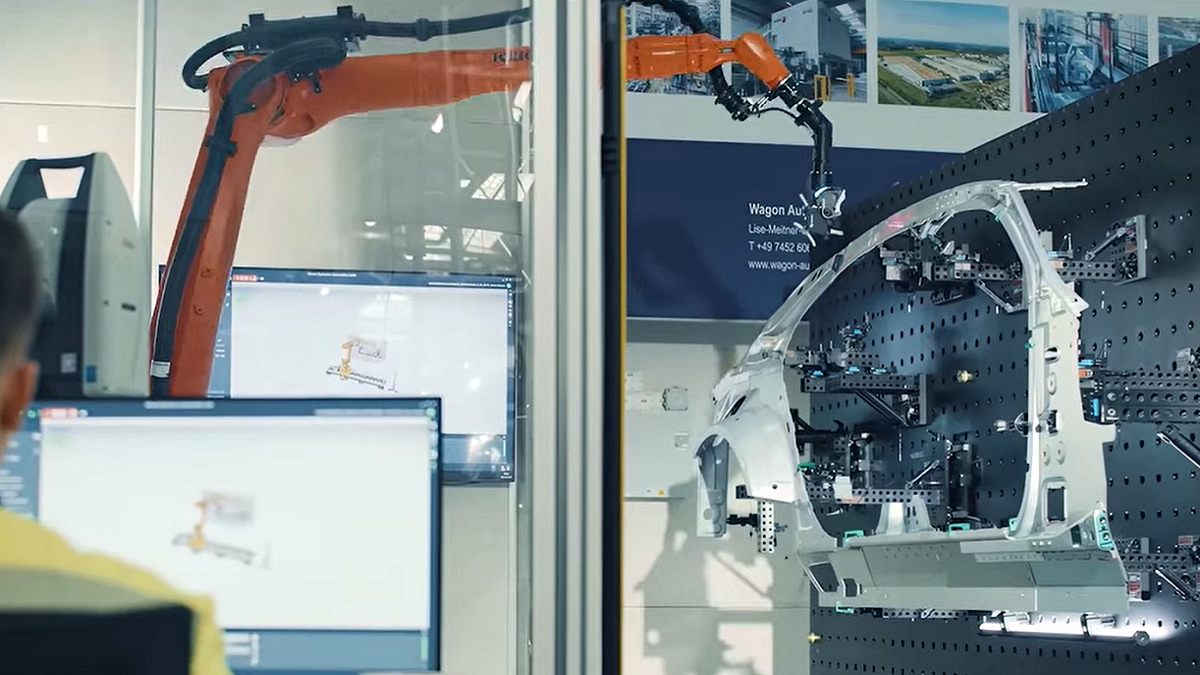

To address these challenges, automation specialist Eleven Dynamics implemented a fully integrated inline metrology solution. The system combines a KUKA industrial robot, a Leica Absolute Scanner AS1 paired with the AT960 laser tracker, a motorized turntable, and Eleven Dynamics’ EDAS (Eleven Dynamics Automation Software) platform.

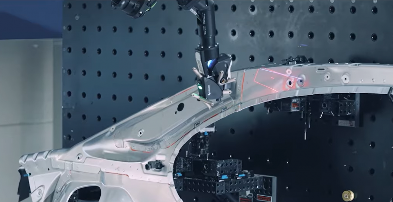

The robotic cell enables automated scanning of complex chassis components directly within the production workflow, capturing measurement data with absolute values rather than relying on relative positioning methods.
The inclusion of a turntable allows parts to be rotated during scanning, optimizing robot travel paths and enabling complete part coverage without repositioning. This configuration significantly reduces cycle times while maintaining measurement accuracy.

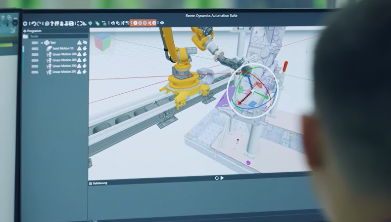

Operators highlighted the usability of the EDAS software, particularly its intuitive programming environment and seamless integration with CAD models. The software simplifies robot path planning and eliminates the need for operators to manually manage complex coordinate systems, making it easier to program measurement routines for new parts. “EDAS made inline measurement faster, easier, and more reliable.”

Since deploying the system, Wagon Automotive has reported improvements in both inspection efficiency and operational flexibility. The automated cell can handle a wide range of part geometries, including components that were previously difficult to measure using manual systems.
By integrating scanning, robotics, and advanced automation software, the company has reduced calibration and maintenance requirements compared with older measurement equipment.
