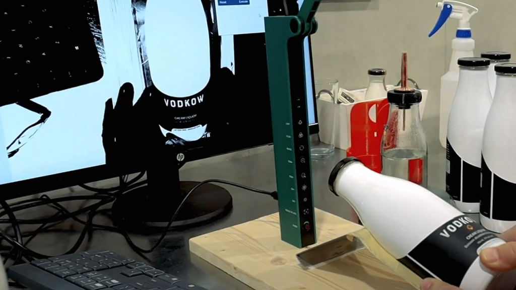

Operating in a highly competitive market, brand appearance is a key factor in ensuring consumer shelf appeal. The distillery’s Vodkow bottle integrates machine-placed labels with a distinctive emblem that is hand-placed by a human operator. The operator needs to accurately align the emblem with brand elements on the main label to ensure a consistent and appealing shelf display.
“We’re a world-class product, and our packaging needs to look perfect every time,” said Neal McCarten, co-founder and Director of Marketing, Dairy Distillery. “When you say you’re making vodka from milk, it can be a leap of faith for a consumer until they taste the product. Our packaging fashioned after a traditional milk bottle and eye-catching labelling is a real shelf talker that helps a consumer connect with the story behind the product. Consumers often judge what’s inside a bottle based on its appearance.”
To help ensure brand consistency, the distillery uses Pleora’s AI-based Visual Inspection System to add decision-support for manual labelling processes. The camera-based system integrates pre-packaged AI plug-ins that are easily trained on a customer’s unique requirements to visually highlight product differences and deviations for operators and inspectors on a display. The distillery trained the Image Compare plug-in to identify key brand elements on the bottle, with a real-time on-screen image overlay then guiding operators as they manually place the emblem. In addition, the system can be used as a training tool to teach new employees on brand quality standards.
The Visual Inspection System helps the distillery reduce costs and avoid production downtime, as labelling errors can be avoided or detected earlier in the process. As Dairy Distillery seeks to further automate production processes to keep pace with growing consumer demand for its products, it is now investigating ways to use Pleora’s system for quality control (QC) checks for in-production and finished goods.
