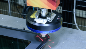

The core of this revolutionary workflow lies in the ability to scan, analyse, and project deviations in real-time back onto the part surface. By combining the precision of PolyWorks and the advanced capabilities of Virtek Vision, users can experience a level of accuracy that significantly improves in-process efficiency. This real-time feedback loop allows for immediate adjustments and corrections, ensuring the production of high-quality components.
Outlining Deviation Contours
By utilising PolyWorks in conjunction with Virtek Vision, users have the capability to showcase deviation contours in real-time directly onto the part undergoing inspection. This instant feedback loop facilitates prompt adjustments and corrections, guaranteeing the manufacturing of components of the highest quality. The feature is particularly advantageous in applications like composites, sheet metal dents, paint, non-destructive testing (NDT), and material control on castings.

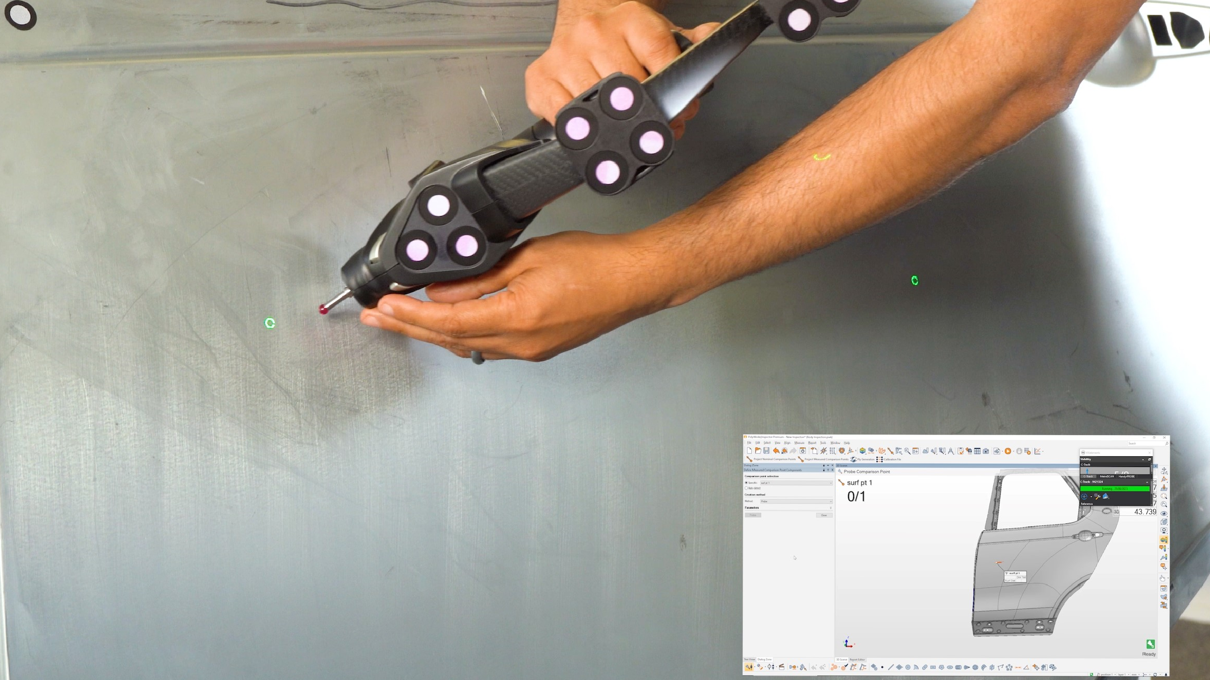

Another application use of PolyWorks integrated with the Virtek system is to guide probe points effectively. With Virtek’s capability to project probe points directly onto the part, users gain a visual guide, eliminating the need to constantly reference the screen to gauge proximity. This feature ensures precise probing without the inconvenience of constant screen checks.
