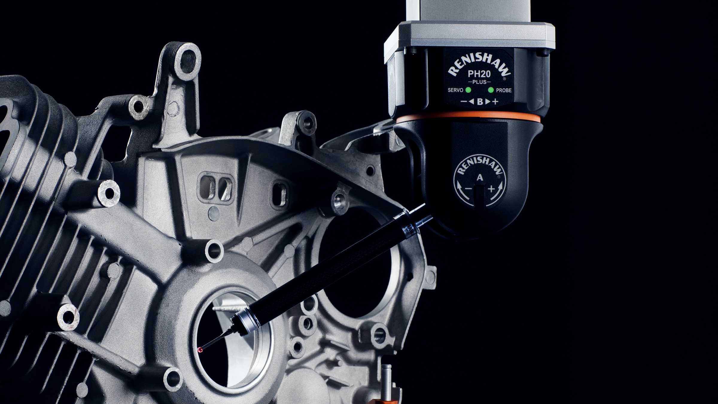

Renishaw has introduced the new PH20 PLUS 5-axis touch-trigger system for coordinate measuring machines (CMMs) at IMTS 2026 to replace its established PH20 head. It offers over 50% increase in inspection reach over the original head, which will improve access to features deep inside parts and in hard-to-access areas. The new PH20 PLUS system builds on the proven measurement capabilities of the PH20, enabling high-speed touch-trigger measurement across a wider range of applications.

The redesigned A-axis features a new kinematic mount that supports a wider range of probe module extensions. This enables the PH20 PLUS head to use longer and heavier probe configurations giving users improved access to features deep inside parts and in hard-to-reach areas. The result is an additional 107 mm of reach, significantly increasing the accessible measurement volume without compromising usability.
With a 50 mm stylus, the PH20 PLUS head offers a maximum working length of up to 300 mm from the centre of the A-axis, an increase of over 50% compared with the current PH20 system.

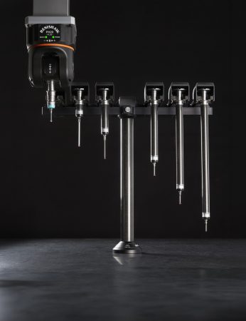

New Modular Rack System for Automated Module Changing
A new modular rack system has been developed to support automatic and repeatable probe module changing with the PH20 PLUS head. The system mounts to an MRS2 rail, which can be installed on the CMM bed or directly onto the machine frame. It includes configurable change ports for TP20 modules, temperature-controlled ports for PE20 modules, and connector modules to distribute electrical power across the rack.
In addition, the powered PCR20 rack provides a standalone solution capable of holding multiple probe modules and accessories, enabling flexible configuration based on application requirements.
