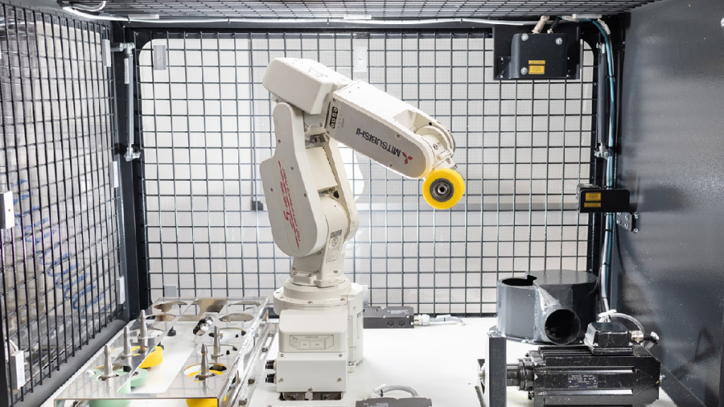

What that means exactly can be best explained by the RoboGrinder. At Düspohl, a mechanical engineering company, the grinding process for the rubber-like rollers that press films against the component when applying them to window frames or baseboards is being automated for the first time. Until now, these rollers, which are known as profile wrapping rollers and tend to have a complex shape, have been ground by hand. This is because automation using control technology alone is not readily feasible for the rubber-like material.
Ultimately, it is based on a target/actual comparison and grinds away all excess material. The problem: The roller material is so elastic that it springs back after grinding – a behavior that is very difficult to model and integrate into a control technology approach. This means that numerous grinding processes are required – but the closer the target, the more inefficient the process becomes. Also, the quality of the surface can deteriorate with the number of grinding processes.
“We document any grinding errors that occur during each grinding process and use it to train an artificial intelligence model – so the AI takes over the correction, especially during fine adjustments,” says Koppert. “Comparatively, you could say that control technology serves as a crash barrier, while artificial intelligence ensures that the curve of the road is negotiated in the best possible way.” In this way, the process can be reliably automated for the first time. For profile-sheathing companies in the building component and furniture industry this means they can reproduce spare parts at their own plant within minutes. Not much space is needed for this; the prototype measures just one by two meters.

The researchers at Fraunhofer IEM initially mapped out the grinding process digitally. The result: RoboGrinder can eliminate 15 percent of grinding operations when regrinding from the approximate to the specified size. The advantage becomes even clearer when regrinding used rolls, where the grinding process takes place directly on the sensitive area – which means regrinding must be performed extremely carefully so as not to remove too much material. “Using the digital twin, we were able to show that we can eliminate up to 40 percent of the grinding process,” says Koppert. Other advantages of RoboGrinder: The specified size is guaranteed, the shape of the workpiece is detected independently by a laser scanner and the machining process is configured automatically. The setup time is also unique: It only takes a few moments to go from planning to completion.
