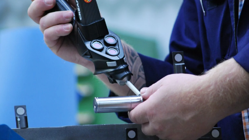

Rebecka Tegnander at Mitsubishi Logisnext Europe AB, which is responsible for supplier quality, contacted Anders Carlström, who is a 3D measurement technician for MLT machines and laser technology. He presented the 3D measuring products MLT offers and shortly afterwards, he came out and gave a demonstration onsite to show what 3D technology could contribute to quality control. No plans were put in place there and then, but shortly after the demonstration, there was a need to replace the company’s original measuring arm. That said, both hardware and software were replaced with Creaform’s HandyPROBE arm-free portable probing system and the Polyworks metrology software.

The results of this investment, Rebecka says, are many. But overall, it can be said that the quality of the products leaving the factory is better. It is now also easier to measure and report, so that the client has a better understanding of the results.
“All individual measurement assignments provide an improvement as long as we follow up on them. For example, if we express dissatisfaction to a supplier with a good measurement basis, the next delivery will be right or better, alternatively you can correct an internal welding fixture in the right place thanks to measurement data.
